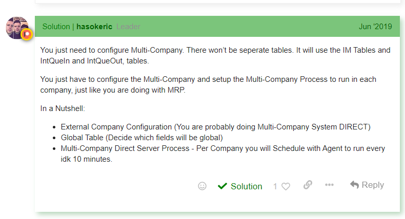

I’m not familiar with the multi-company process, like setting up external companies? I just did a quick search and found this below. I wonder why no one here has ever looked into this before. I went into external company setup and there’s nothing there (least that I can see). So our companies aren’t talking to each other like they should?
Never mind, I just found the external company setup. Had to change the system to Multi-Company Direct. We have PO suggestions setup already. But we’re looking to bypass suggestions so our other company sees jobs sooner than they are now.
