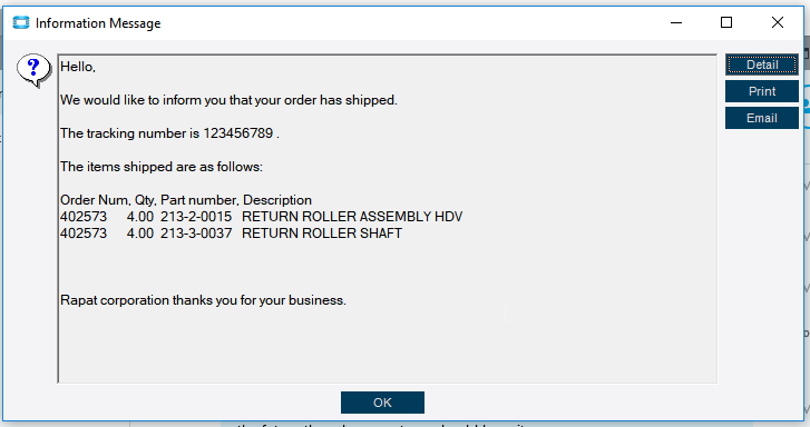

So this is the final (kind of) result. I’ll be putting this into a simple auto e-mail and probably some other information.
Here’s the code in the code block
string mystring = "Order Num, Qty, Part number, Description"+ Environment.NewLine;
foreach(var row in ttShipDtl)
    string peice = string.Format("{0}      {1}  {2}   {3}", row.OrderNum, row.OurShippedQty, row.PartNum, row.LineDesc);
    mystring += peice + Environment.NewLine;
 this.OrderLineInfo = mystring;
