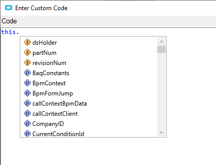

ok, so there are multiple ways to figure out the parameter name…
  1. in the C# Editor, you can type the word “this.” and then press the Ctrl Space key. It will display a list of possible variables. Here you will see that there is a variable called partNum and this is what you are looking for. You actually dont need the “this.” portion in your code, (its ok to leave here though).

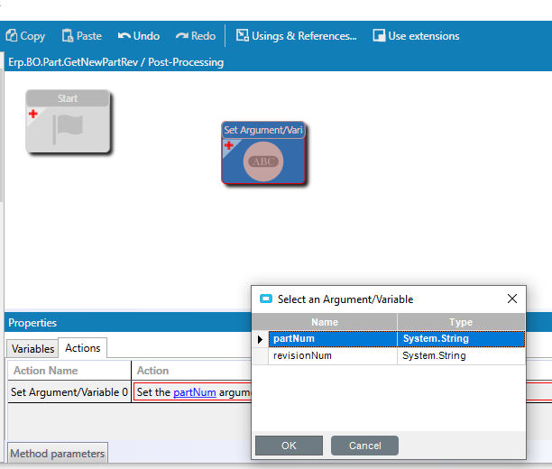

Another way is to simply use the Set widget for setting parameters, and then look at which parameters are available. In this list, you can see them:
I figured it was something simple. Thank you!
