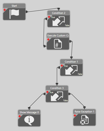

The BPM is on the Labor Update
Condition 2: The ttLaborDtl.LaborType field of the changed row is not equal to “I”
Condition 1: The ttLaborDtl.LaborQty field of the changed row is more than the callContextBpmData.Number03
Condition 3: the method is called by Manager
Show message in case the user is allowed but warned
Raise Exeption 1 if the user is not allowed

In Kinetic 2022 I had a similar error condition, on the same Labor.Update BO. In my case the error did not occur on our PILOT system, but did on the LIVE system. The difference was that the BPM on LIVE had a condition entry before the custom code block, just like ‘Condition 2’ in the diagram, whereas on PILOT this condition did not exist.
Resolution was to delete the ‘Condition 2’ block, and add its condition criteria as another line in the ‘Condition 1’ block (i.e., after the custom code block). I did not need to alter ‘changed row’ to ‘updated row’ on any of the condition criteria.
