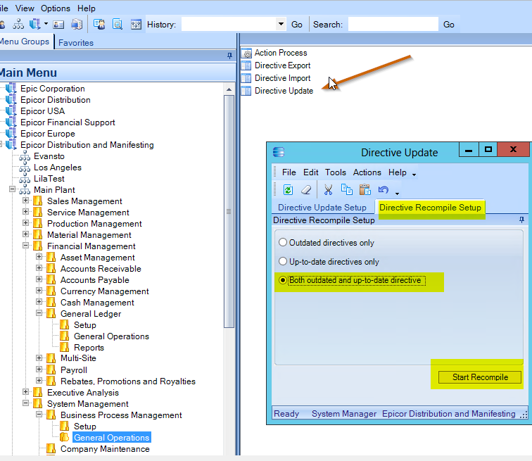

We have never recompiled any of our BPM’s in the past. What does this actually do? Could it affect anything at all in live, where we would want an immediate backup to put in place, if something were to go wrong?

Recompiling all BPMs in Test will not impact anything in Live–someone would have to do some major reconfiguring to have Test affect Live and it wouldn’t be a concern I would have. There are conditions that could prevent a BPM that is technically enabled in the Test database from actually triggering/executing. The recompile will basically force every BPM that is enabled in the application to actually trigger if the condition is met for that BPM as long as the recompile doesn’t throw any errors during the process.
The objective by recompiling all enabled BPMs in Test is to determine if having all of the BPMs actually triggering if performance is close to the performance in Live. If it is, then one of the BPMs would be the reason why it takes a long time–lots of reasons for that. If having all the same BPMs in Test enabled and triggering that Live does and if Test is still faster, we’d have to look elsewhere in the production environment for a cause.
