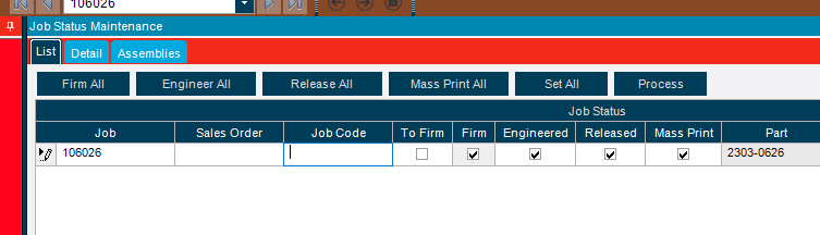

We want to add the order number to our jobs (we are make-to-stock) so I’ve added a UD field to JobHead called DemandRef_c and have added it to the Job Status list view. I then created a BPM data form.

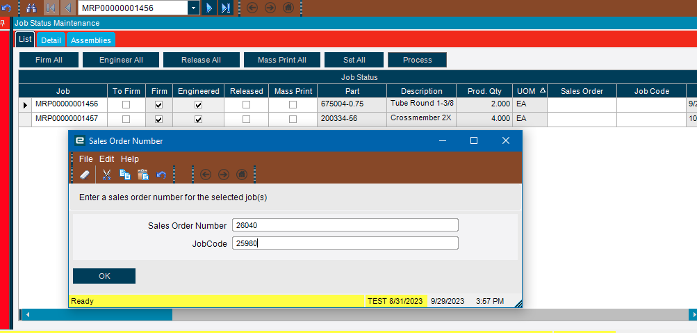

The plan is when firming the jobs the data form opens and the user inputs the order number. This get entered into all the jobs being firmed in the grid in Job Status Maintenance. The UD field is working correctly and the BPM data form opens when I click “Firm All” and “Process” in Job Status Maint. however the fields never update.

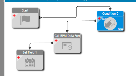

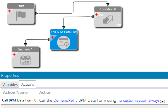

Here’s my BPM. I’m using a similar workflow as shown in this thread.
BPM Data Form
My condition is:
My BPM Data Form is:
My Set Field action is:
My expression:
My UD field just never gets updated. Am I missing some code somewhere?

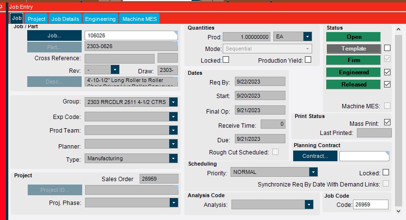

My fields are good because I can add data in job entry and it shows in my BAQ.

I also went back in and rebuilt the preprocessing BPM to set the fields and it simply doesn’t have any effect. I had trace on when it ran and it did not change any fields.
I again went in and built the preprocessing BPM to trigger the post processing BPM. This time I added a message to show me the preprocessing was triggering the post processing. I then added the data form on post processing side then set field widgets to un-release and un-engineer the jobs, set fields to add the BPM data form information and widgets to re-engineer and re-release the jobs. Finally a message to tell me it happened. Everything runs and all messages trigger.

OK, We want to add a sales order number to our job travelers. We make everything to stock but production (and Sales) wants to know what order the jobs go to.
To do this I first started manually adding the order number to the JobCode field on JobHead table. That field shows in Job Entry and works great for what we need. But to add the order number for a hundred jobs we want to use Job Status Maintenance. But the JobCode field is read only in that screen and I can’t get it to change with extended properties. Epicor support says it is read only. So I added a UD field so I know it won’t be read only in the Job Status screen.
I want my BPM to run when after I firm a job then click the Process button. My BPM opens a data form window, I enter an order number and it populates the UD field on each job in the job status screen with that number using a Set Field widget.
I can’t get a preprocessing BPM to do that so I tried using a post processing BPM. It adds the order number to the UD field but the number disappears as soon as I click off the row, like it updated a temporary field instead of the permanent field.
I’ve tried several ways to get this to work and even put in an EpicCare case to no avail.
So to spell out what I’m looking to do, I open multiple jobs in Job Status Maint., firm the jobs and click Process. My BPM data form opens and I input an order number. (in my example I’m testing both my UD field and JobCode). Epicor should firm the job and add the data form information to the fields.
It does but the order numbers disappear as soon as I click off the row.
