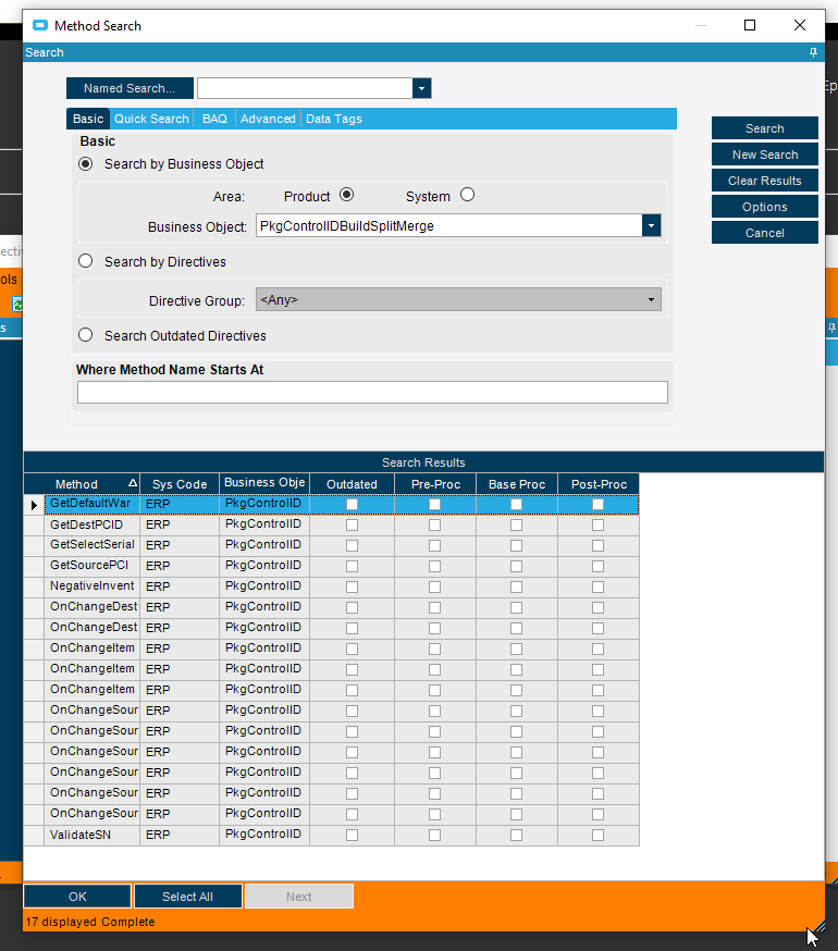

We need to be able to put a BPM for printing on a method directive to do some bartender file drop printing. The method that we need the BPM on is in the database, however it doesn’t show up in the UI list to pick so that we can make a BPM. When I look in the back end, I see that all of the methods that don’t show up on this list for PCID Build Split Merge have a signature status of -2. Does anyone know what this is used for, or why these methods are not is the list?
Directives Recompile, has a checkbox to refresh Signatures. Run that and it should refresh your Signatures.
Can you see those methods in your system?

Let me check
that would be a no… bummer.
Im just going to assume it means that they haven’t been implemented yet to support PRE,POST.

If SingatureStatus is -2 then BPM does not support such a method. There a many reasons for that:
  1. Unsupported types in the signature
  2. Conflicting names of tables in tableset arguments (a few arguments of the same tableset type or tableset types with identical table names)
  3. Too long method name
  4. something else
