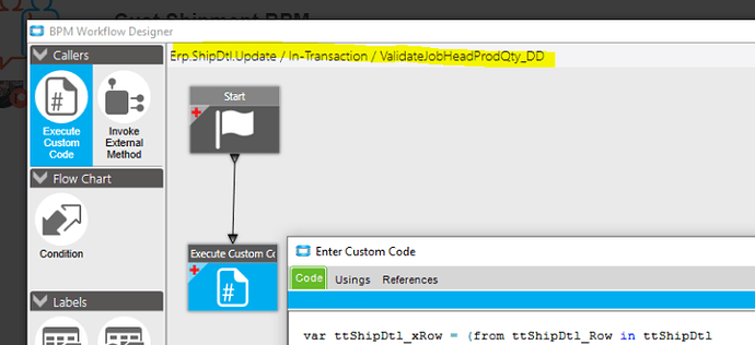

Also my BPM work flow designer is not showing the custom code option
my work flow designer
from another post.

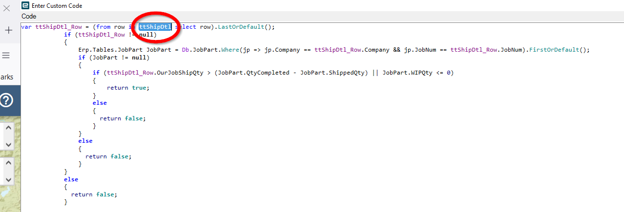

Double click highlights the ttShipDtl as circled below

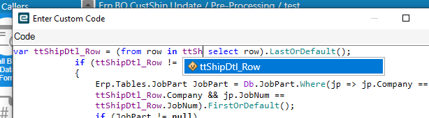

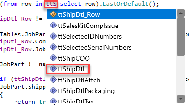

Sorry I missed the ‘Also, if you type ‘ttSh’ and then CTRL+SPACE does it…’ This is what it give
nhutchins
(Norman Hutchins)
July 22, 2021, 3:54pm
12
