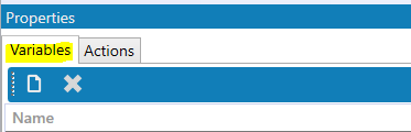

As for a dataset, Look in this post, in the code part.
Also, you may be able to define a variable of a tableset you need there instead, have to add the right references and browse for it I think.
