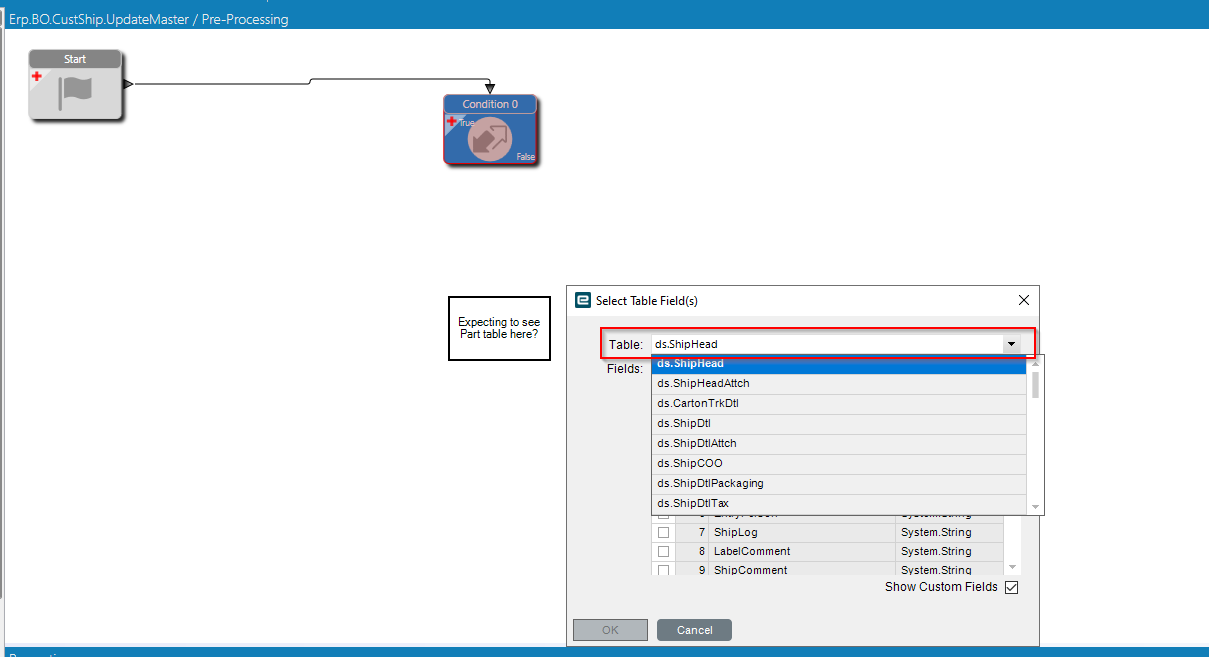

My problem now becomes when I add a condition widget/shape, it does not give me the part table in the drop down
In that condition widget type the only tables available will be the transient data tables used for that BO and screen. You will need to pull in the Part table through a query condition. Note that before you do that you will have to get the keys needed to join the part table from the ttShipDtl table first. You can’t do a direct join between the Part and ttShipDtl tables unless you want to have a real bad time. I would create a local set of variables to store Company and PartNum and then use those in your query condition.

It is the same condition widget, but a different option for the widget.
