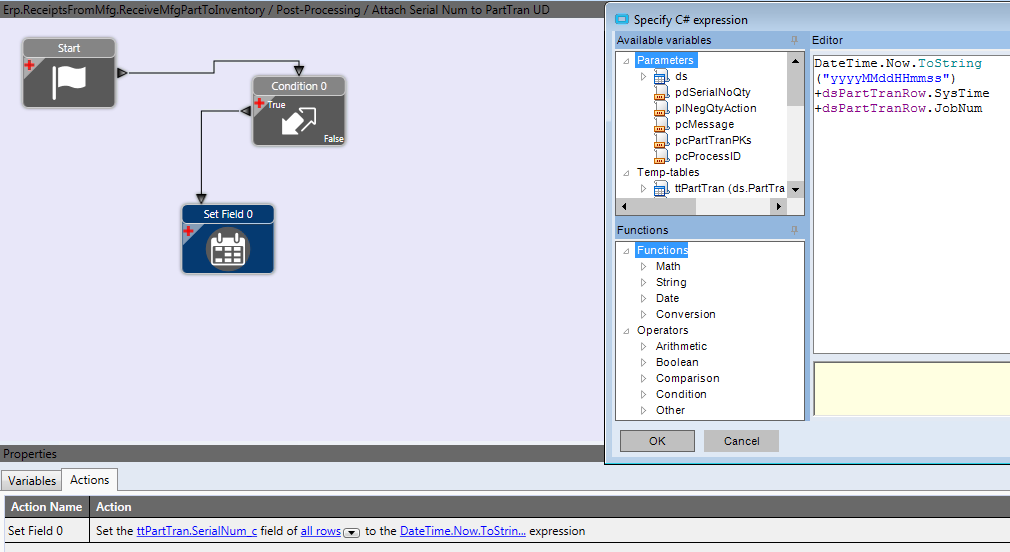

I previously tested the BPM to update the TranReference field which worked for a “unique” Serial number for the labels, but that was replaced for the Auto Receipt to Inventory when those happen.
I added a UD field to PartTran and am trying to assign the value to that field, but it doesn’t look like that’s happening, I’ve already run the regenerate data model. Am I missing something?
BPM and Data in SSMS:
Edit: Tried both Pre Processing and Post Processing

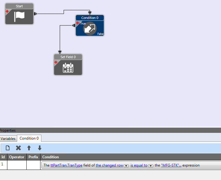

Are you sure your condition is being met?
Yes, the condition is met. I took it out, and still have the same result.
Edit: Looks like the BPM works using Job Receipt to Inventory, but not the Report Qty for MES, the MES is setup as a MFG-STK transaction
Post processing won’t work since the record has already been saved. You re going to have to lookup the part tran record and then update it.
Set Field i supdating the TTRecord (temporary record) which has already been commited to the DB
This needs to be done in preprocessing otherwise
