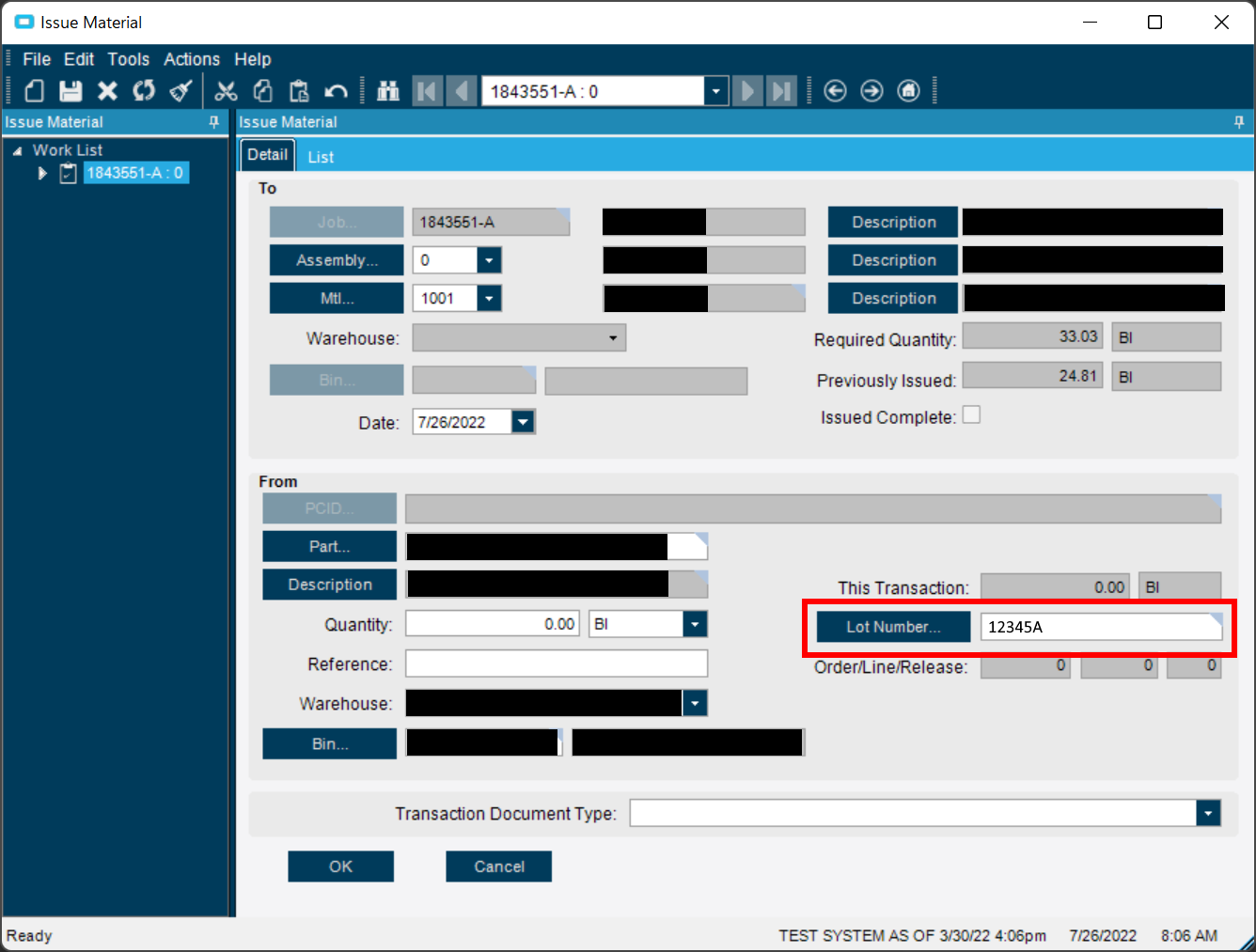

On the Issue Material screen, I need to catch when a user enters a LotNumber and run some logic against the entered/selected value.

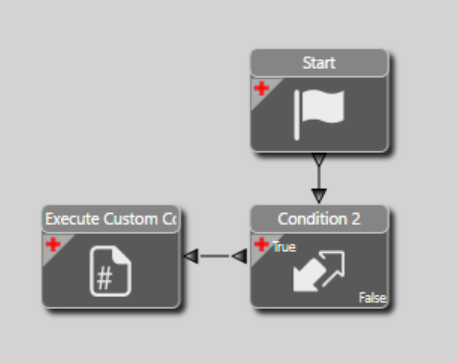

I would think that a Method Directive BPM for this would be the proper plan of attack, so I started a trace and saw that OnChangeLotNum method was being called from Erp.Proxy.BO.IssueReturnImpl when a new LotNum was entered/selected. Using that knowledge, I created a Pre-Processing BPM on Erp.IssueReturn.OnChangeLotNum.
That BPM has a few blocks:
- Start
- Condition Check to ensure RowMod is “U”
- Custom Code block

So, my question is: is there a better way to basically ‘revert’ everything that happened in OnChangeLotNum? I tried setting the pcLotNum to null and “” with no avail, that causes a box to appear saying that a Valid Lot Number is required.
I have also tried to set any relevant fields in ttIssueReturn back to their previous values, and nothing seems to do the trick. I have tried doing the logic strictly using conditional blocks in the BPM Workflow Designer, and my results are the same as when I did it all in the Custom Code block.
Any advise as to how I can ease this headache and get that LotNum field back to a blank state?
