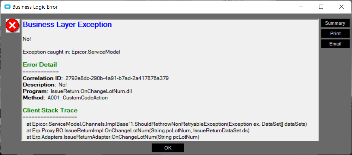

I have some custom code that runs in a Pre-Processing BPM. That code does some work and will set the value of a variable to either true or false.
When the code is done running, there is a condition check to see if that variable is true. If it is true it branches off and throws an exception. But, I get 2 boxes that appear. This happens if I throw the exception using the BPM designer, and if I do it in a custom code block.
First Box:
Second Box
I don’t know if this is normal behavior or not and I was wondering if anyone here can chime in.

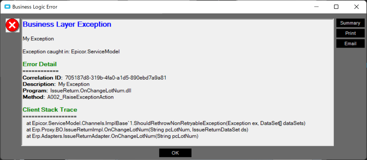

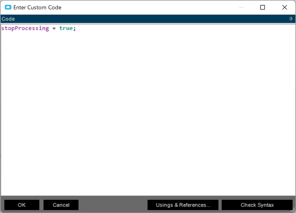

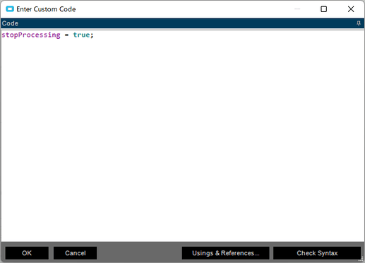

@jtownsend - for the purposes of this discussion, the code block is this:

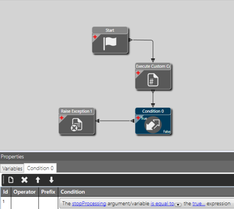

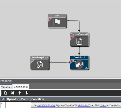

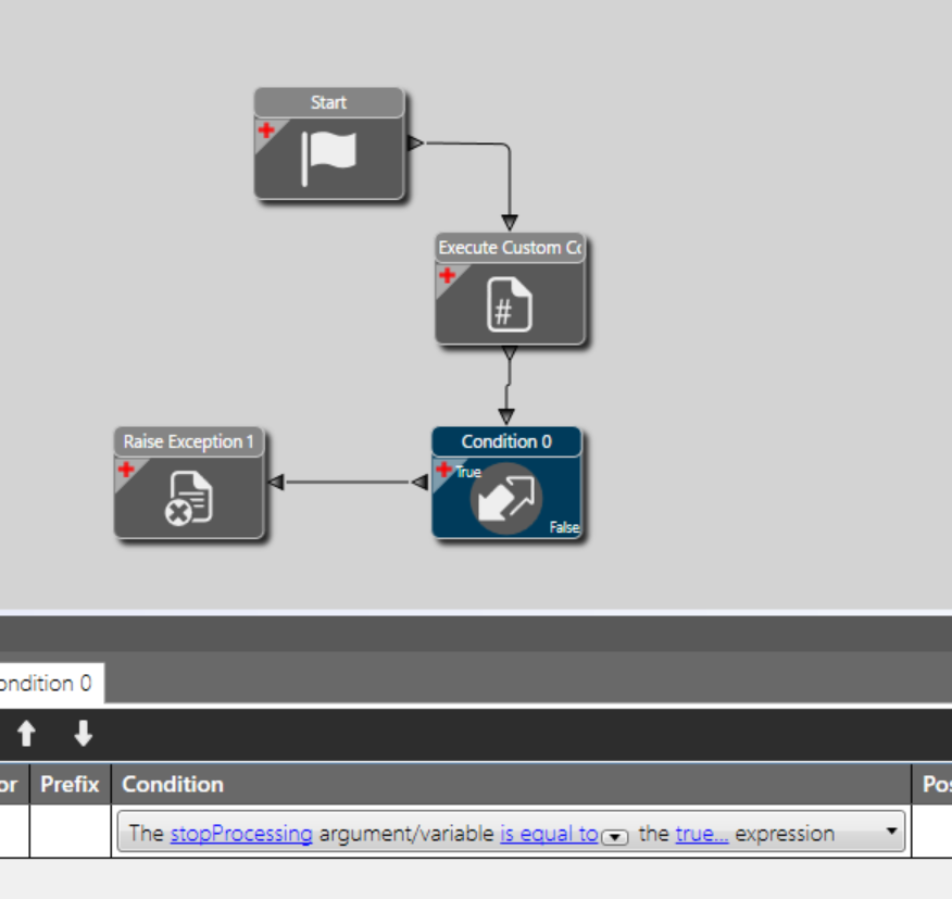

Short, sweet, and to the point. Then, in the Condition, I am checking to see if stopProcessing is true, then throw the exception.
Conditional Test:

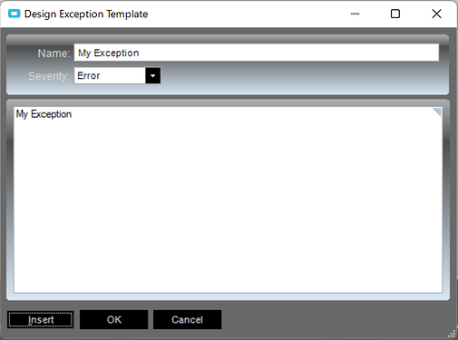

Exception Template:

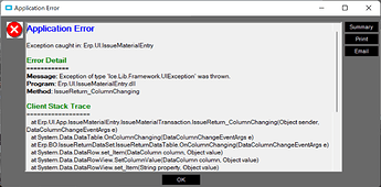

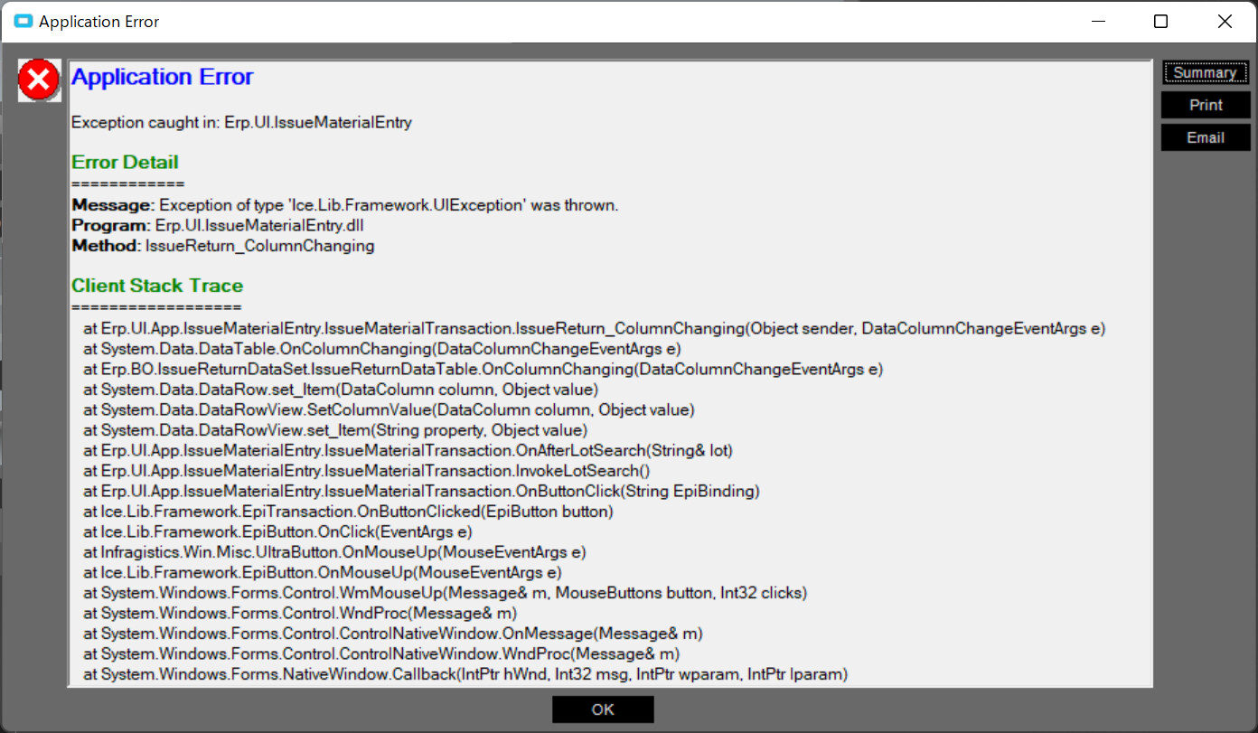

That is when I get 2 exception windows displayed (one after the other).

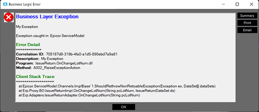

Exception #1:

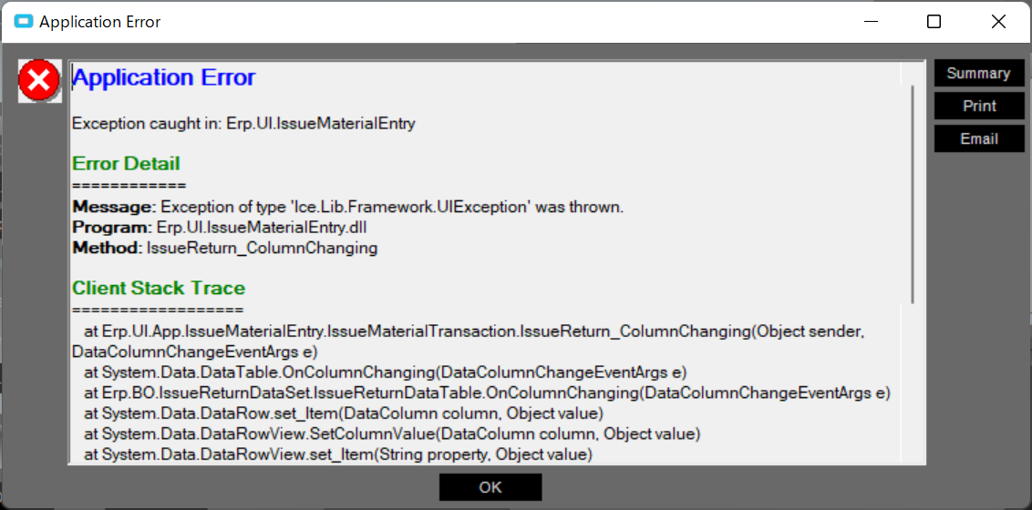

Exception #2:
And just to be sure that there wasn’t something else interfering, I removed the link from the Conditional block to the Raise Exception block, and tested it. No exceptions were thrown. I put the link back in place, and I get 2 exceptions.
For what it is worth, I also get the same issue (2 Exception messages) if I do a:
throw new Ice.BLException(“Message”);
from within the code block. (that is with deleting the “Raise Exception” block from the flow diagram as well)

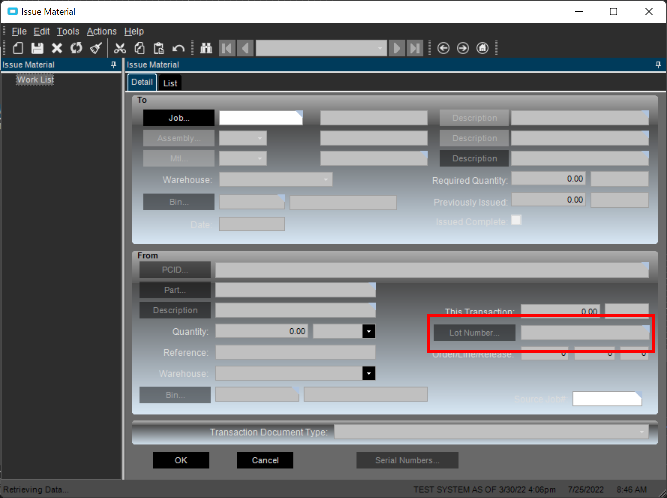

this looks like something happening because one business object (issue material) is calling another (create lots) and your error message happens during the create lots, which is then crashing out the issue material object… I have not seen this happen before, but it might explain what is going on… if you do the same logic against the ABC Code table, i think you will only see one error.
I am not creating any lots with Erp.IssueReturn.OnChangeLotNum. This is being called on the Issue Material screen when a user enters/searches for the Material Lot Number to issue to a job.
Erp.IssueReturn.OnChangeLotNum is called when a value is entered into the LotNum field of the Issue Material screen.
That is when I take over in the BPM by setting stopProcessing to true and checking it with a conditional block right after.
Unless I am misunderstanding the Issue Material screen, there are no lots being created, only searched for or keyed in.
You may be best off handling your Exceptions in the Update PRE Method.
You are doing everything right, but sometimes the UI’s need to play nice as well and in this case this specific event isn’t. I usually avoid OnChange Exceptions because the methods often aren’t meant to be interrupted.

No problem, I figured it was a long shot! For anyone coming behind me – I moved the check to the PartTran Data Directive.
