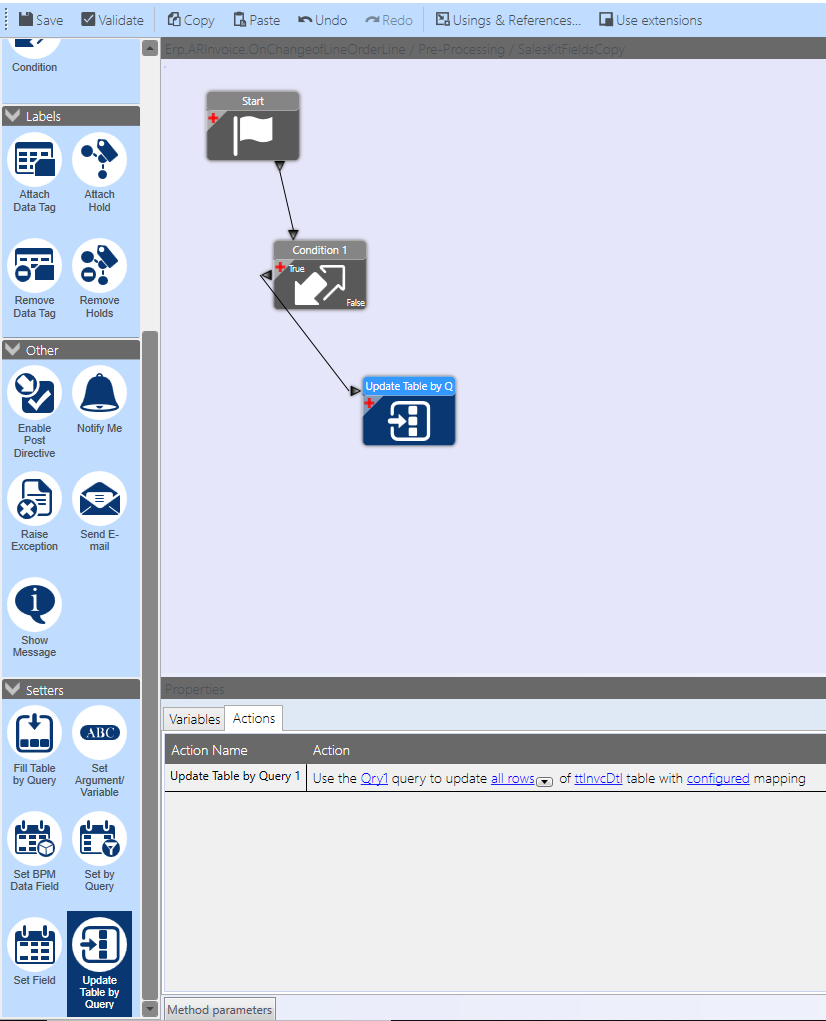

I have a similar issue. I have two UD fields in OrderDtl and I want them to populate two UD fields in InvcDtl which are identical. I thought I could use a BPM without code, but I am thinking I will need it after reading this post. Any pointers?
What is the point of storing the same data in two locations? Can you not just join the tables to get to the fields?
Not that two fields is a big deal, just could see this method get out of control in the long run.
Because it may not always be the same I would guess. If you update your master file you don’t want to retroactively change all of your transaction records at the same time.
good point.
I think a BPM should work though, when field changes update other ud field.
@knash, Mike is correct. It changes all the time. So I need it to copy whatever is in the field directly over. I have run a BPM several times (no code) and it will not copy the data from the field in OrderDtl to InvcDtl.
what does it look like.
I would guess an conditional widget.
Then a GetById widget
Then a set widget
Then an update widget
That isn’t working?
I’ve had different versions:
Condition Widget
Update Table by Query
I do not see GetById Widget.
Here is the screen shot of the latest one I’ve tried:
You will need to get the record you want to update, by using the Invoke BO Method widget
Fill/Set record by using a setter widget
Then Update it using the Invoke BO Method widget.
