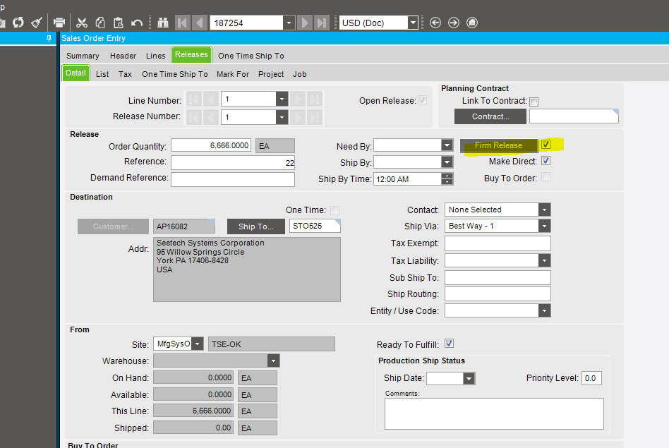

By default when an order line is created, the release is firm.
The first release is created automatically once the line is entered. What I am trying to do is create a BPM that checks the release as UnFirm.
I started at using the Method SalesOrder.GetNewOrderRel for my BPM. However, I cannot get the BPM to work on the first release that is created automatically. When I add a new release, the BPM works. Its just that first release.
Any Ideas??

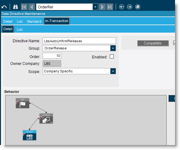

I would use a Data Directive on OrderRel ,
Condition if new release, set the field to desired value.
Pierre
This should be a Data Directive - InTransaction BPM.
Add a condition to check for any “added” row to the OrderRel table.
Set the FirmRelease field to false.
