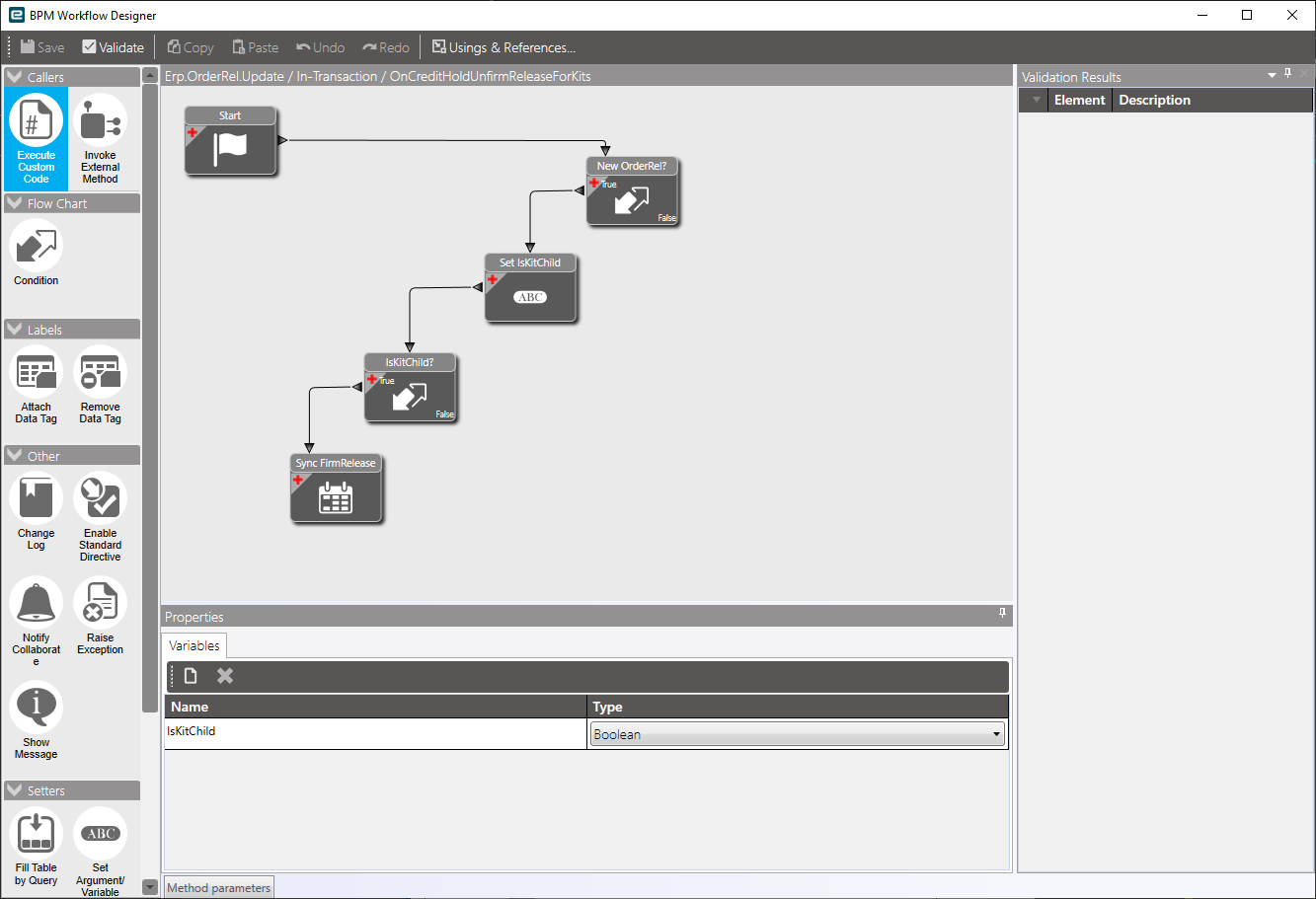

i have followed this article to make my releases unfirm by default:
BPM to Make New Order Release UnFirm - Epicor ERP 10 - Epicor User Help Forum
it works, the release is unfirm and a BAQ ran on the orderrel table also shows the data has been written correctly…so far so good!
the issue is when creating an order from a quote, even though the release is unfirm it still shows as a manufactuing suggestion in Planning Workbench - as far as the planning workbench goes it still shows the releases as being firm…
It appears there is a process being called named SalesOrder.ChangeOrderRelFirmRelease - i believe this process being called is what updates the table the planning workbench looks at.
i am really struggling on how to call this process to make the data correct throughout the system (unless of course i am completely looking at the wrong thing)

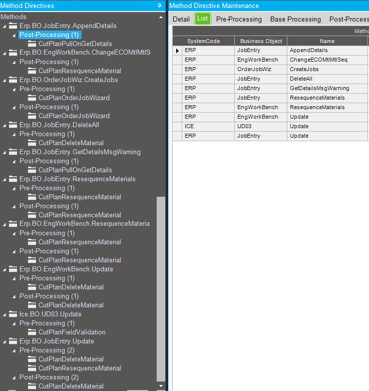

There are several Method Directives you will need. In addition don’t forget the first release a Line creates (it magically appears).
You would think that Epicor would call GetNewOrderRel everytime, like it should cough @timshuwy but it doesn’t… So you have to do alot of juggling :slight_smile:
Maybe Tim knows a better way to cover all scenarios.
If I had to do it over again.. I would make a UD Column UnFirmRelease_c on OrderRel… then replace it on the UI and then I can modify the original one in Pre MasterUpdate or Data Directive… but then I would have to also handle the Row Rules that UnfirmRelease handles… Not sure.
Yea, the BPM that is changing the orderrel table so it looks unfirm also needs to adjust the PartDtl table.
Yes, I would LOVE IT if the OrderRel table worked like all others, but there are a few tables in the system that “must” have a value.. OrderRel is one of those… for every OrderDtl record, there MUST be an OrderRel, so there is a database trigger that creates the first one, and that is not visible in a pre-processing BPM for you to adjust. that means you have to do it POST processing (after the OrderRel is already created.
The same thing happens in Part… when you create a Part, and save it, the system automatically creates multiple records… partplant, partcost, etc that are REQUIRED, but you cannot access that data in a pre-processing BPM during an ADD.

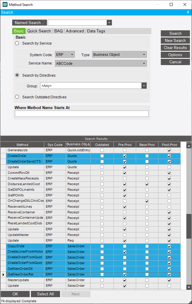

What I wish it did call GetNew for all the other methods:
  1. Quote.CreateOrder
  2. Quote.CreateOrderSaveOTS
  3. SalesOrder.CopyOrder
  4. SalesOrder.CreateLinesFromHistory
  5. SalesOrder.CreateOrderFromQuote (there are 2)
I think some of them just use BufferCopy… If you want it to reset on a new Order Number, sometimes you have to go after all the Method Directives.
