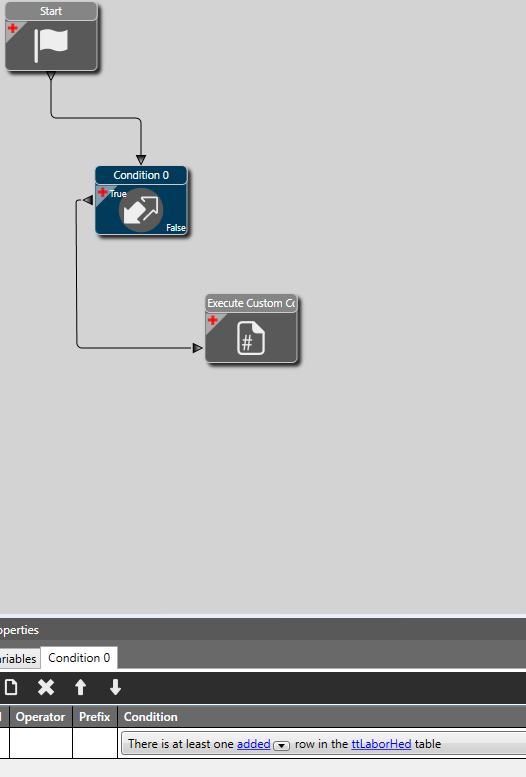

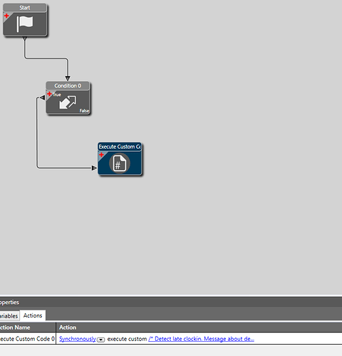

Can you post images of your BPM?
Sure. Images or my code?
