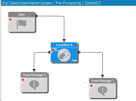

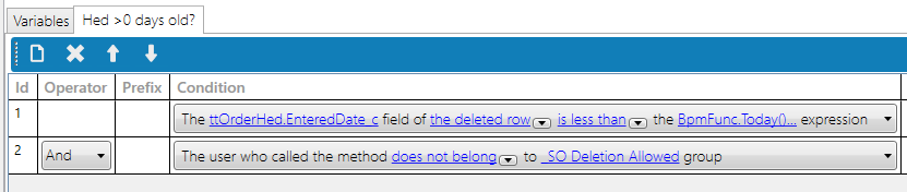

Hi guys,
I’ve been asked to create a BPM to prevent deleting orders and lines if they are more than one day old (if you aren’t a sales manager).
I have the header part working, but can’t get the lines condition to trigger (it still lets me delete). The ttOrderDtl.Rowmod has been changed from any to “D” needed quotes around the D to compile, but it’s not picking it up in the condition (yet the message shows it’s a D).
Suggestions?
Also - Is there a better (more efficient) way I should do this? We have 30+ BPM’s on SalesOrder.Update already! Maybe something other than SalesOrder.Update (which is triggered all the time)?
Thanks for the help!

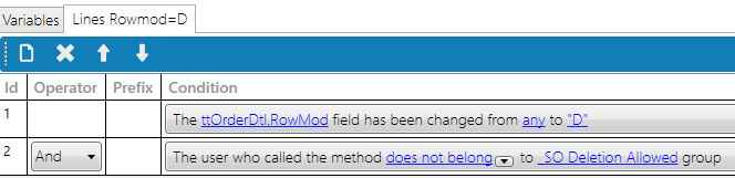

Hey Andris,
I’m not sure why your “any to D” condition isn’t firing, but have you tried using the “at least one deleted row” condition instead? It might achieve the same result you want.

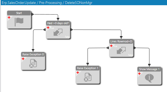

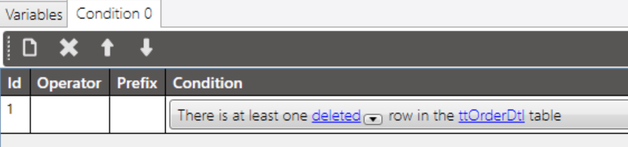

I figured starting simple would be better, so now I’m just trying to make a condition to catch the deleted sales order line. Nothing seems to trigger. I put a message box to show what ttOrderDtl fields are returned, and they are empty. I’ve tried SalesOrder.Update pre, MasterUpdate, and the two Delete BO’s.
Seems like deleting a line does not set RowMod=D, but does put a deleted row into the trace dataset (I’m not sure how to work with that).
What am I missing? Thanks for the help!
