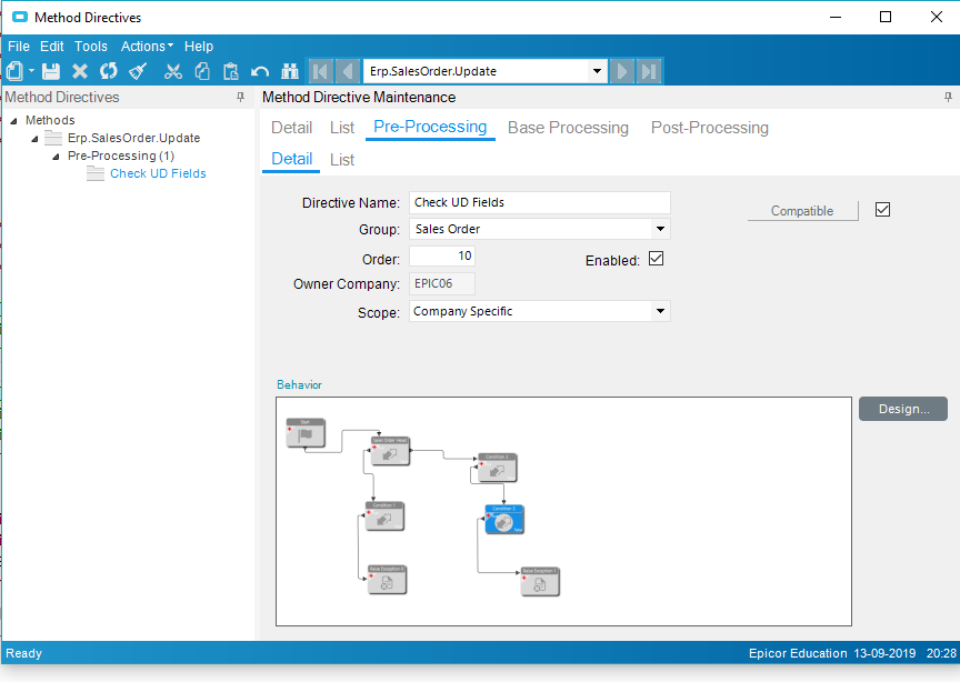

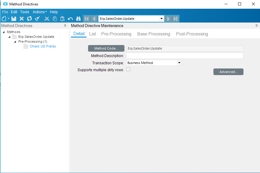

Put it on SalesOrder.Update so OrderHed is done before you start with lines… Something like this.

So the issue I have here is that when I apply this to the SalesOrder.Update, it won’t let me generate the initial Sales order number without the second batch of required fields. What I have right now is 3 required fields that must be filled in order to generate a sales order number…this works fine. After the number is created, but BEFORE a line can be added I need to put the Exception in to look at 5 other fields…when I add this process to the Salesorder.Update, it won’t let me generate an initial order number if one of the 5 is blank…

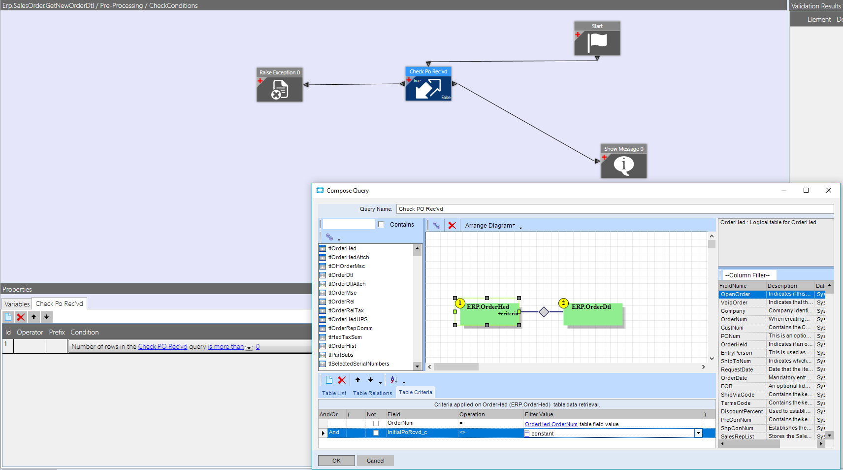

I would do this on a pre-processing Method Directive for GetNewOrderDtl.

Hey Jason
So I had gone down that route but could never seem to get it to flip between the True/False condition. This is what I have set up right now…can you point me in the right direction?
add more condition as you like to validation your ud fields.
Since you should not yet have an OrderDtl record, you don’t want the OrderDtl table at this point. The OrderHed table can be filtered by the variable OrderNum.

So I updated the query and removed the OrderDtl table…but I still receive the exception whether the field is Null or not…is my criteria incorrect?
I don’t see ttOrderHed.RowMod as an option under the table selection…
Insert Condition element and click new on bottom.
