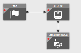

I suppose I should have included what I’ve tried so far! I currently have a Pre-Processing BPM on SalesOrder.Update (all using the Workflow Designer, because I know nothing of C#):
  • The BPM has a variable type of Ice.Tablests.UpdExtUD08Tableset

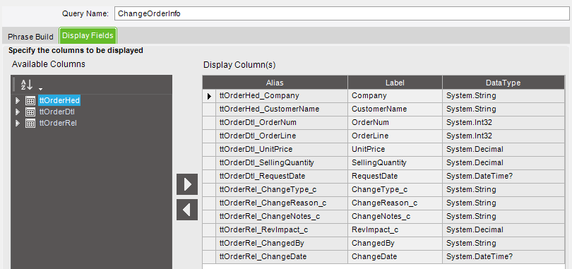

  • Added a Fill Table by Query widget - the query just pulls all of the fields mentioned in my original post, and then maps those fields to the UD08 table
  • Added Invoke BO Method widget, invoking the UD08.UpdateExt
That’s all I have. For the other BPM I wrote (logging the last use date of BAQs and who ran it in a UD table), it works perfectly… but honestly, I have no idea whether the use case can even be applied to this situation. I thought it could as long as I switched it from Post-Processing on DynamicQuery.Execute to Pre-Processing on SalesOrder.Update, but that’s obviously not doing anything!

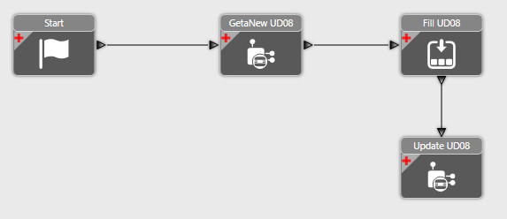

  1. BPM design 1 Design

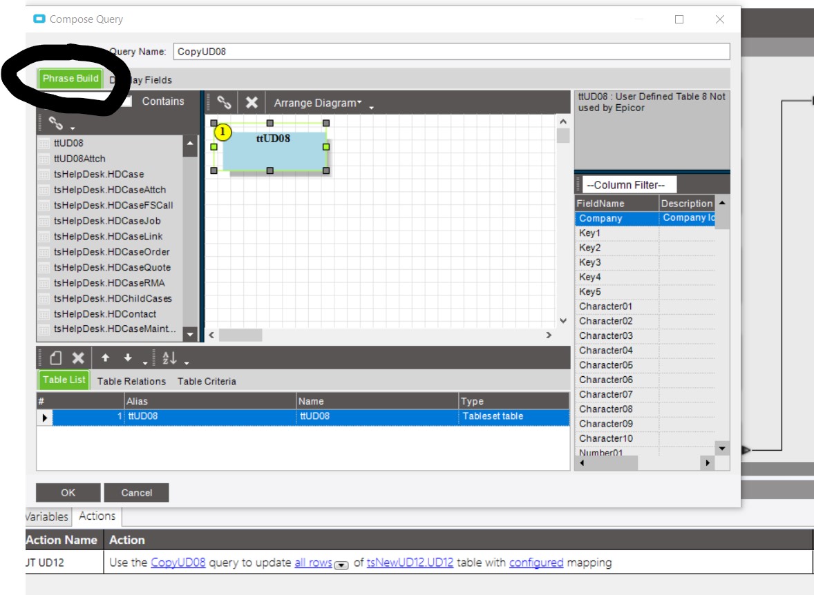

  3. Fill UD08 settings
  4. Query fields
  5. Mapping
  6. UpdateExt UD08 settings

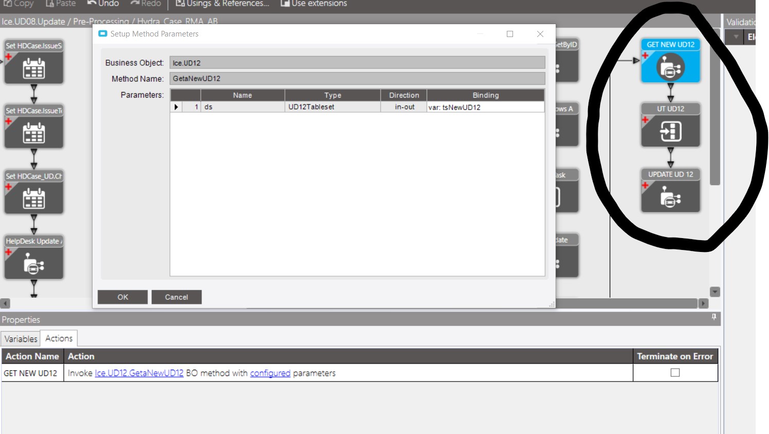

You need the GetaNewUD08 widget as well.

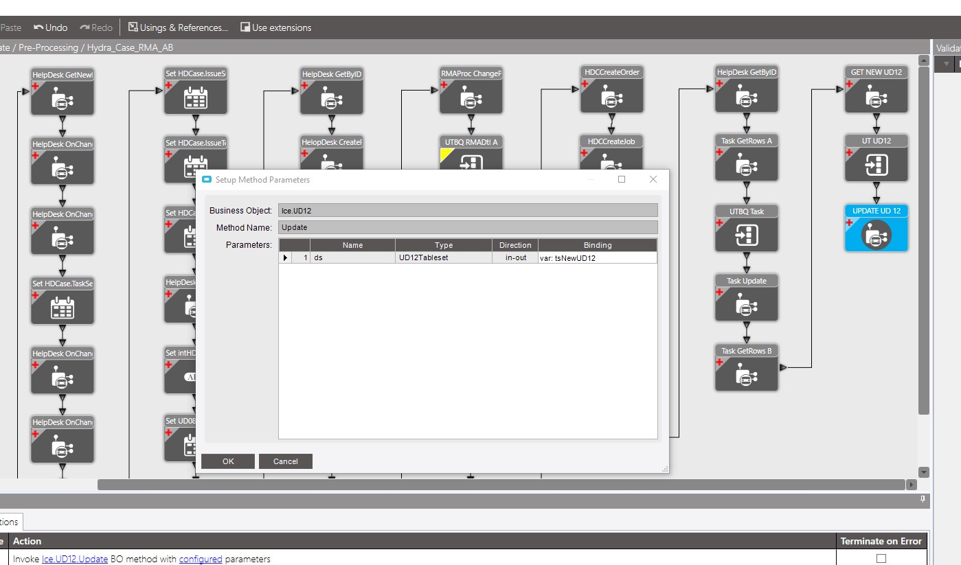

Here is a picture of the update.
BO: Ice.UD12
Method: Update

Correct GetaNew would be first. Sorry I thought you could read my brainwaves from the picture I posted yesterday.
You should be able to add widgets to what you have. If you click on the connector lines you can delete them. Then you can redraw them in the order you want.
Widgets
GetaNewUD08 (The picture show what the widget is calling)
BO Ice.UD08
Method Name: GetaNewUD08
for the parameter you can the one you have or create a new one.
2)FIll Table
  1. Update
I believe the UpdateExt is deprecated, smarter folks can chime in.

What is your query for the fill table? You can hardcode a few to test. Then once you know the creation is working we can focus on getting the real data filling in.
@knash I switched SysRowID to SysRevID, still getting blank records and the Duplicate Row Error (most likely because all fields are blank?).
My query is shown below, except with the addition of SysRowID and SysRevID to the columns.
What does the phrase build look like as well?
@knash
Variable is now “NewUD08” and set to UD08Tableset.
Both GetaNew and Update reference the NewUD08 variable.
Fill widget is set with the query and mapping in my previous screenshots.
sorry I am an it guy so clear communication is hard for me. :slight_smile:
I mean this.
