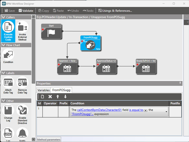

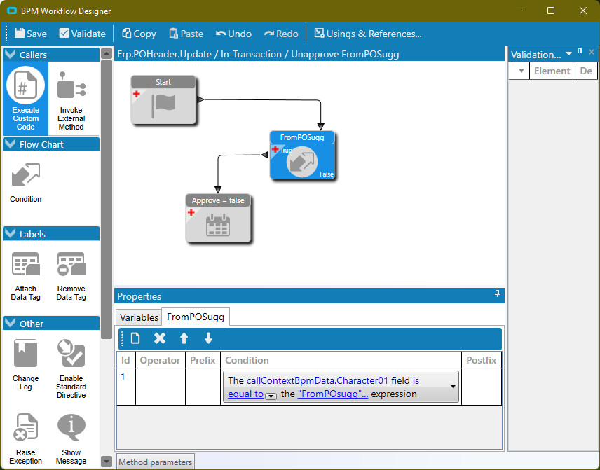

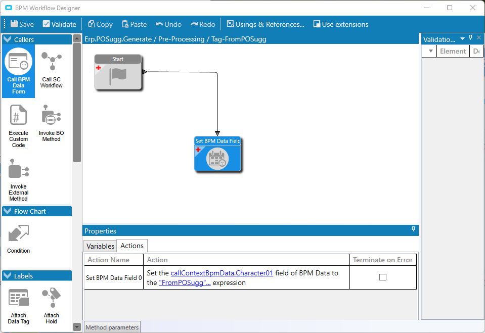

You could try setting a callContextBPMData variable in a post method directive on POSugg.Generate , and then check for that value in an in-trans data directive on the POHeader table. If the callContextBPMData value is present, change the POHeader.Approve field to false. That way it should only happen when the PO is created from the suggestion.
Thanks, @Asz0ka, for pointing me in the right direction; that was the direction I was thinking. Your steps were correct, except I had to do a Pre-Processing on Erp.POSugg.Generate, not a Post. Otherwise, this worked!

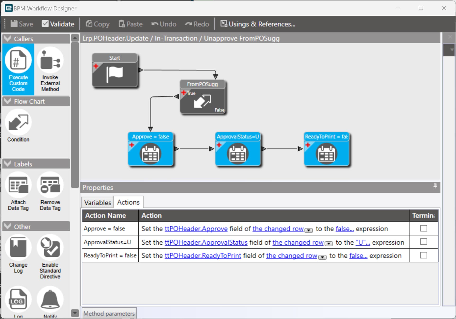

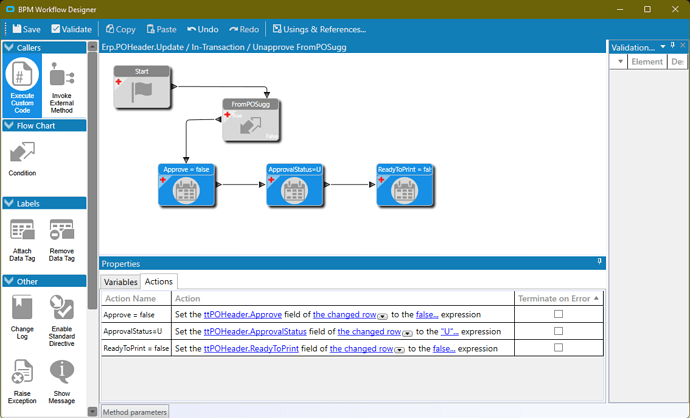

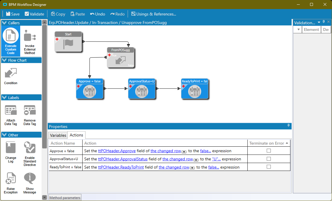

After some testing I realized I needed to set;
  • ttPOHeader.Approve = false
  • ttPOHeader.ApprovalStatus = “U”
  • ttPOHeader.ReadyToPrint = false

In order to get this to work, you need a method directive on ERP.BO.POSugg.Generate / Pre-processing to tag record PO generated from PO Suggestions. So that the Data Directive can id the POs.
The data directive with be on POHeader.Update, the condition is:
Then you need 3 actions to set field values:

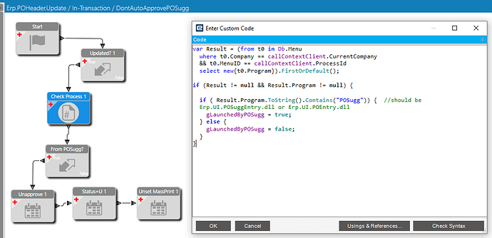

FYI, the way all this works is:
  1. PO Suggestions creates a PO, that is initially unapproved. This is the New record.
  2. Then automatically, PO Suggestions marks it as Approved. This is an Updated record. It is a little tricky to stop this, as if we prevent all PO Header Updates from approving, no POs could be approved. We just want to stop the approvals triggered by POSuggestions.
  3. One way to do that is @nhutchins’ method, with 2 BPMs.

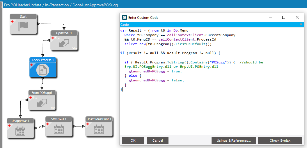

  4. You can also do it with just 1 Data Directive BPM, checking what ProcessID is triggering the table update. I used code but this can be done with widgets too:
var Result = (from t0 in Db.Menu
  where t0.Company == callContextClient.CurrentCompany
  && t0.MenuID == callContextClient.ProcessId
  select new{t0.Program}).FirstOrDefault();
if (Result != null && Result.Program != null) {
  if ( Result.Program.ToString().Contains("POSugg")) {  //should be Erp.UI.POSuggEntry.dll or Erp.UI.POEntry.dll
    gLaunchedByPOSugg = true;
  } else {
    gLaunchedByPOSugg = false;
