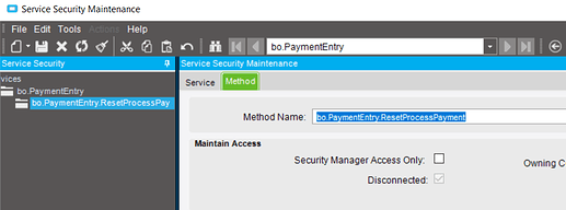

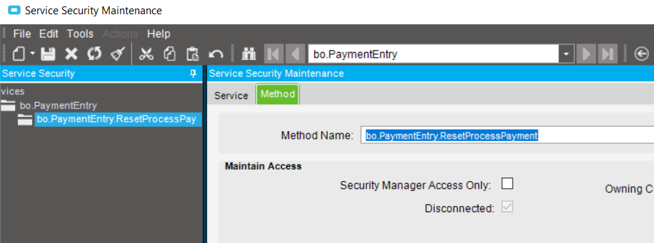

I think my business object is Payment entry and my methodname is GetRestartProcessPayment. I found these in the trace log.
