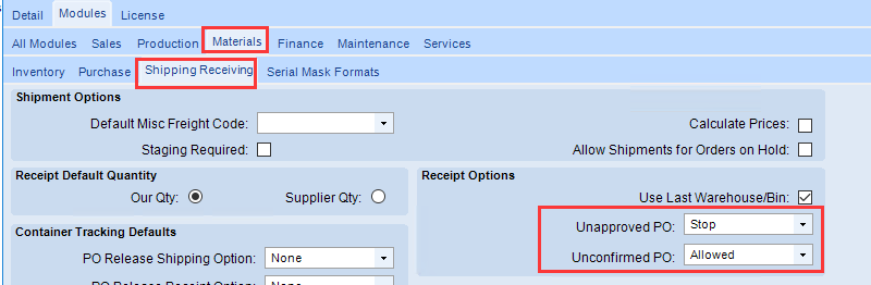

From 10.1.400 onwards, the system already has standard functionality, and you can enable it directly without any additional BPM.
Go to System Setup–>Company/Site Maintenance–>Company Configuration
