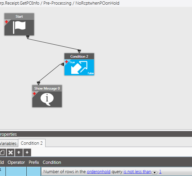

I changed True to true and now the compilation errors are resolved. But… the BPM triggers regardless of whether the PO is on hold or not. The query only has the POHeader table in it with the criteria of OrderHeld = true. The Condition is 'Number of rows in the orderonhold query is not less than 1.
Paste a screenshot of the BPM and any related elements within.
You need to link ttPOHeader to POHeader in the diagram view. Make sure you join on Company = Company AND PONum = PONum.

ttPOHeader is not a choice in the list of tables on the compose query screen. Do you mean ttRcvHead?
~;)Karen

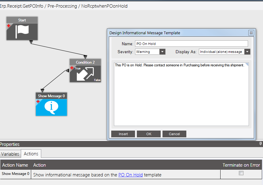

Screen shots of the Workflow Designer and the Compose Query screens…
Here’s the Show Message…
You need the ttRcvHead or Dtl to link to the POHeader. Right now you have a BAQ just floating in there not attached to anything contextually.
