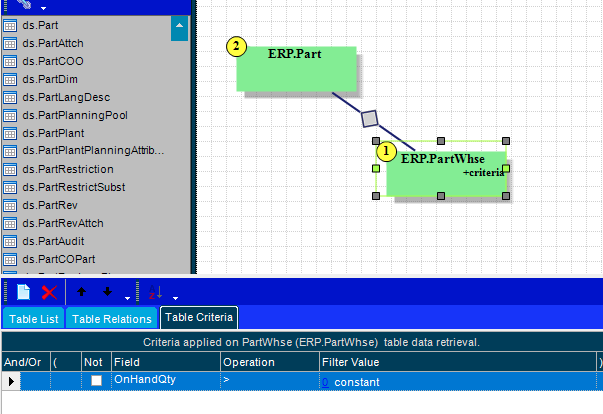

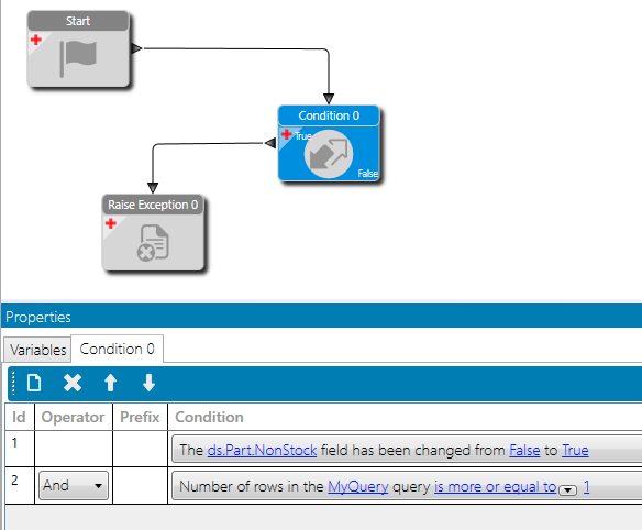

I’m working on a BPM to stop someone from changing a part from Stock to Non-Stock if there is inventory quantity of that part. I’m making a pre-processing method on the Part Update business object. I have 2 conditions, the ds.Part.Nonstock field is changed to True and my BAQ returns a line.
I set up my query for Part and PartWhse with a criteria on the PartWhse where OnHandQty > 0.
The BPM seems to fire on all parts instead of parts with just inventory.
I am guessing my query isn’t right. Any ideas? TIA
Self fix. I needed to link the ds.Part table to the ERP.PartWhse table. Once I did that the rules worked as I needed them to.

Agree, he could(should) have used his first query against the both ERP. tables and set a condition using the ds.Part.PartNum as a query condition on his first attempt and this will be more efficient in terms of the actual query code generated by linq against the SQL DB.
I read the thread and I get the gist of it but I don’t know how else to create the query to trigger the exception. Is there a better method?
You set a variable (like immediately after the Start widget) for the part number, equal to ds.Part.PartNum (or whatever it is).
Then in the query window
Only have one table (Erp.PartWhse, I guess)- Don’t use a
ds(ortt) table - Give the Erp table(s) a criterion of
Part = MyPartVariable
[Edited for clarity.]
I get it now. I don’t use variables much in BPMs so it was a new learning curve but that works like I need it to. Thanks
