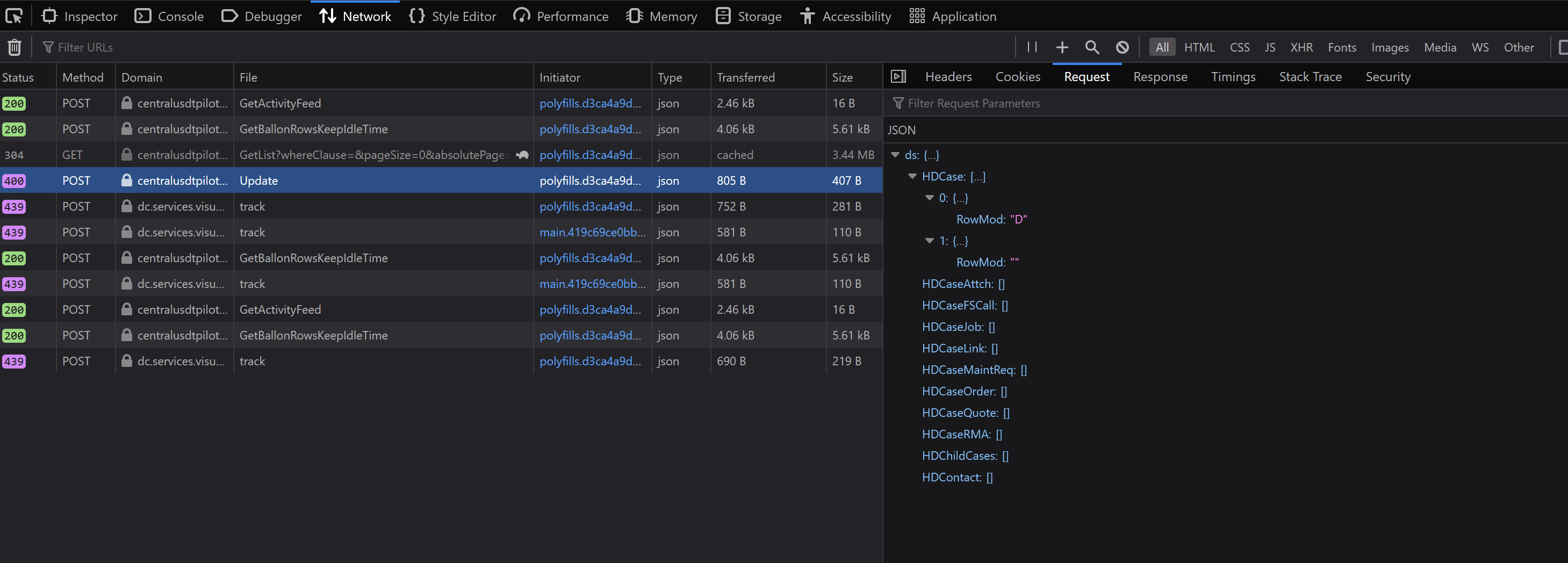

When I look at the call to the Update method, there are indeed (2) records being sent in the dataset - one empty except for a RowMod value of D, and one completely empty.

That’s common. You’ll have to account for that in your conditions.
First thing, is yes, you’ll have to put a condition block that tests if the RowMod == A (added) or U (updated). D is deleted. Blank is unchanged. You don’t want the BPM to fire on unchanged or deleted rows. If you have old records with wrong owners on them, clean that up before you turn the BPM on.
Second, rather than test for numeric values on update, I’d tie all of the groups to a dummy salesperson, leaving everyone else tied to their person record. Then maybe run a BPM on the CaseOwner drop down that filters out non-person records.
But I always try to tie objects together and build logic off that. That way, I don’t have to rewrite code when management decides to change the numbering scheme.
Thanks John. I did have a RowMod condition on the BPM checking for ‘A’ or ‘U’ and I still received the error. It seems like there should only be one record in the dataset being updated but an empty one is being appended.
It’s typical for Update() calls to take a dataset and then return the updated dataset. So, yes, you can have multiple rows, but by the same token, it’s not really going to care about unchanged rows since it expects them. Often, I have to place the Update call within a loop and call it repeatedly for each record. I don’t think that applies here though.
I also recall it throwing the multiple row error if (when adding a row) a field isn’t set correctly, resulting in a key collision.
If I’m on a deadline, I’ll toss the validator on a data directive, since you don’t really have to worry about datasets in those. But I try to come back and do it the right way. Also, as I said above, you should try to filter things before the Update step.
Understood, thanks again John. I may go the DD direction if necessary.
