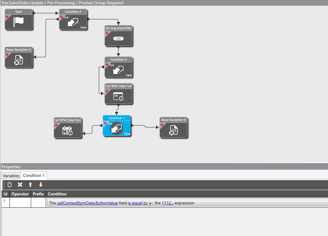

Only issue is I am not calling MasterUpdate or Update. I can’t see any way I am creating an infinite loop. I just set a context variable or raise and exception, depending on what button they press. What else could be causing this issue? I tried disabling all other BPM’s for the SalesOrder BO but the error persists.

I did a trace. MasterUpdate is showing up twice. If I turn off the BPM, it only shows up once. But I am not calling MasterUpdate or Update anywhere in this BPM. I added I message box right after the BPM form, it does not display, the error message happens before that.

I’m not sure if you are addressing me or the other posters, but I was careful to state I disabled ALL other BPMs, and you can see from my diagram I am not calling Update or Master Update from my BPM.
