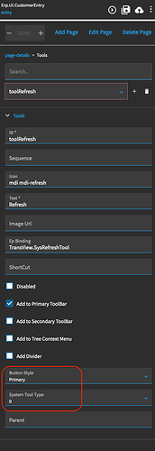

The reason I’m trying to read the layout.jsonc files is that I’m having issues in App Studio that I cannot fix in the UI. Specifically, the refresh button in Customer disappeared completely in one of my layers. I never removed it, but it is gone. I can add it back, but App Studio keeps defaulting the tool properties to have a style of “Primary”. Removing Primary and 0 in these properties won’t save:
So my plan was to physically remove the Primary and 0 values from the JSON file.

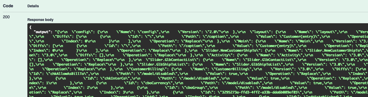

This is what I’m seeing when I run the function to parse the string:
Is there an intermediate step I’m missing? The code is very simple:
string json = "{\"config\":{\"Name\":\"config\",\"Version\":\"2.0\"},\"layout\":{\"Name\":\"layout\",\"Version\":\"3.0\",\"Diffs\":[{\"Id\":\"\",\"Path\":\"/caption\",\"Value\":\"Customer(entry)\",\"Operation\":\"Replace\",\"Index\":0}],\"Operation\":\"Replace\"}}";
output = Newtonsoft.Json.Linq.JToken.Parse(json).ToString();
No, but you are missing something :wink:
If you are expecting the return from your function to look like json, then you are out of luck out of the box. “output” is a string, not an object, thus it will be serialized as a string.
You can go vote on the idea linked in my main thread, and for now use the workaround I posted there by encasing it in a dataset.
If you need more help with that let me know.
