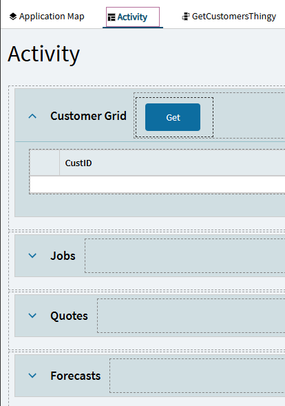

I am attempting to wrap my head around how to pass the output parameter from a function to a data view. In this use case, I am adding a panel grid card to the Activity panel in the Part Tracker module:
The idea is that when the button is clicked, it will pull the top 10 listed customers within the customer table in Epicor. However, what happens currently is the form loads, and the panel grid is grayed out, like it’s not initializing correctly:
Any tips and tricks on how to troubleshoot this would be greatly appreciated.
Attached, you will find the simple library and function I created for this attempt, as well as screenshots that denote the steps I’ve taken thus far.

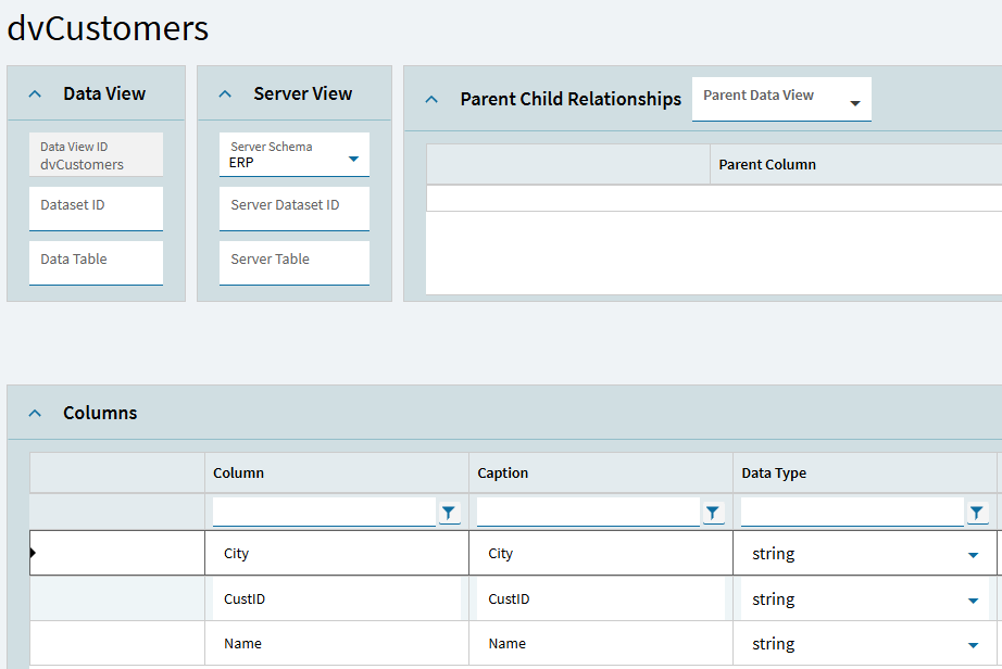

Data View:

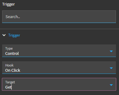

Event:
Control:

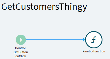

Kinetic-Function:

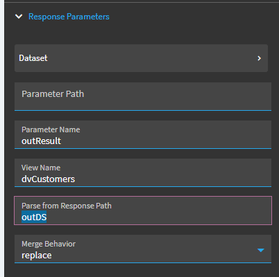

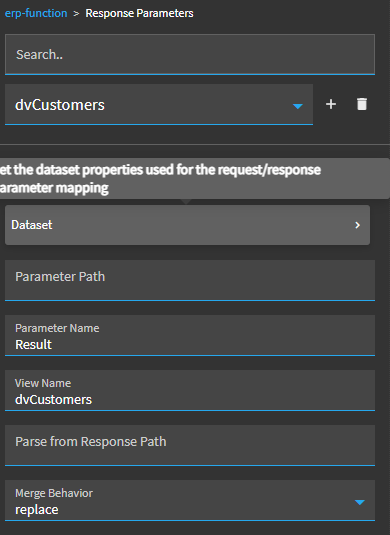

“Parse from response path” should be the name of your dataset in your function signature on the “Response Parameters” side. For example, here, “Parse from response path” would be “outDS”
That is a DataSet, a DataSet contains DataTables (or can be empty/null), so at some point in your function would have needed to add a DataTable, containing DataRows, with DataColumns and Values to your dataset, to have data in it. that DataTable has a name, and that name goes into “Parameter Name”. It would have been set up in the code with "DataTable xyz = new DataTable(“Result”); or similar, if your DataTable is named “Result”
The grid being greyed out is due to setting up an epbinding at the panel-card-grid level, remove this and put the epbinding one level deeper at the “grid model” level.

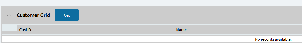

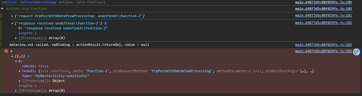

I was able to implement the changes you recommended and the grid is no longer grayed out.

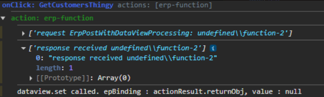

Now though I am getting an error in the console but do not understand how to start troubleshooting this. It errors every time I click the button so at least works the way it should:
Any recommendations on how to interpret this?

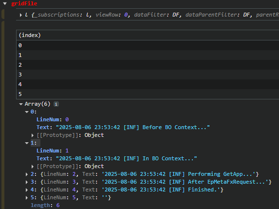

It doesn’t tell you anything useful, these are errors generated from the MetaFX JavaScript that lies underneath Kinetic, not a direct issue with your set up, but some issue with your set up triggered that error in underlying code. We could get some meaning from it with attaching a debugger, but if you look higher in the console, probably there is more info that is useful. Ensure that you have debugging on (ctrl-alt-8) before pressing the get button.
Here’s the new error:
I’m defiantly adding that crlt+alt+8 command to my spell book.
It looks like the function is running but not returning expected data.
With ctrl-alt-8 active (debug mode on), while clicked somewhere in your app window (not in the dev tools window) press ctrl-alt-v. this will populate the dev tools console window with your dataviews in memory. There will be system dataviews and application dataviews.
We would expect to see your output in the Application DataViews → Results DataView, use the > arrow next to it and > again on the array(xxx) to see the rows inside. If there isn’t any, data didn’t get transferred from the function to the dataview correctly.
You should expect to see something like this:

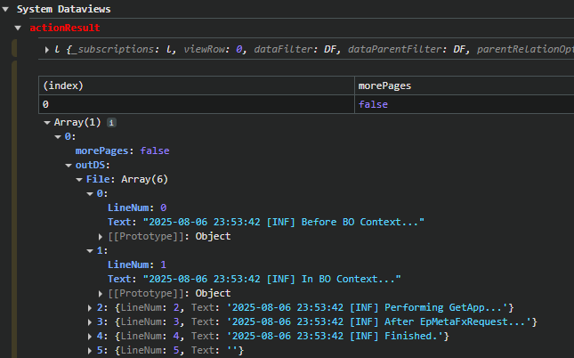

Check in System DataViews → actionResult, what’s there? all output from the function (regardless of what you’ve set up in the REST Response Parameters) should be contained here.
When I run a function that outputs a DataSet named outDS, with a Table named “File”, two columns named “LineNum” (int32) and “Text” (string), with n number of rows, this is what i see:
If you don’t see expected output here, the problem is not with anything on app studio side, the problem is on function side. Get the function to output what you expect here first (if you have data here, please show us a screenshot) - then you can work on getting the output into the DataView correctly.
So I do not see anything in the results data view.

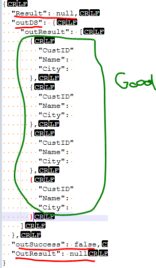

I went ahead and put the function in an access scope and gave it an api key for testing. I see the data I expect in there for my 10 customers. However, I do not see data in our other return sections:
I also had to made a few small changes to the code you provided to get me to this point:

Response Parameters:
I feel like I’m really close to having this working.
Thanks a ton for helping me learn this stuff! You’ve been a great help!
With what you’ve shown, if you run this function from the button in app studio with debug mode on, then check the dataviews, I would expect to see your data now in System Dataviews → actionResult → outDS → outResult → (rows of data)
Assuming that it is there, and you have set up a “dvCustomers” DataView to receive this info (you could have no fields at all in this dataview, it isn’t necessary to receive the output) - all you need is an empty DataView with a name.
Note: if you have ever clicked that “dataset” button, there used to be a bug in app studio that would corrupt the kinetic-function component and you had to delete the component and rebuild it without clicking this button, if you see everything is looking right and still not working, try to delete the component and re-create it at the end.
(note that in your function response parameters, you only need outDS in this case. outSuccess and outResult were there because I took the screenshot from another function I made, sorry for confusion! in this case all we need the function to output is the outDS object, and the output from your API call to it looks exactly right.)

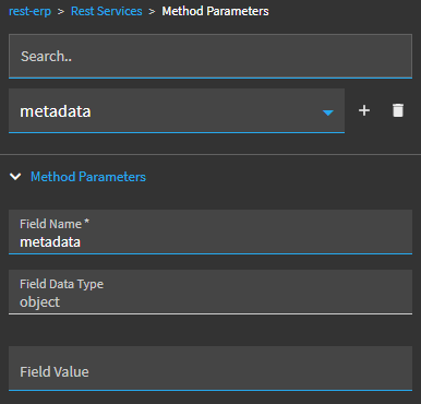

@GabeFranco I feel like I’m working on a very similar issue but trying to put the returned object from the function in a different place. I’ve got a function that returns an object called metadata and I want to use the metadata object as a parameter in a rest-erp widget for the docstardownloadfile method.
    "MetadataDS": {
        "metadata": [
                "_TableName": "Erp.Project",
                "_TableSysRowID": "34b2d142-60fc-420f-bab0-e7c3c2dbc2d7",
                "ContentItems": "1"
Should I save this into a dataview? If so how do I point to the dataview as an object?

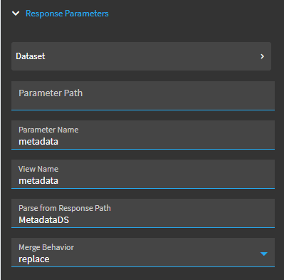

Create a “metadata” dataview. (just give it a name, no set up other than that)
Set your kinetic-function component response parameters like this:
Since you are only returning one row of data, don’t need to worry about using a row-find/row-current-set to pick a particular row of data (if you had more rows, you would!)
now, to use any of the values in the currently selected row of metadata in app studio, reference it as the standard {dataview.fieldname} - in this case {metadata._TableName} would go into the rest-erp parameter.

The problem seems to be what the Rest-erp widget is expecting for metadata, it doesn’t want a specific field from the dataview (ie Erp.Project) it wants the object that holds all of it. I need to send an object and not a value. I think even an empty object would work but I couldn’t figure out how to do that either.
                "ContentItems": "1"

It looks like the expected input that the api is looking for is a JArray. You might be able to use javascript to build the correctly formed json in app studio to pass it directly as a parameter.
I can’t remember the exact syntax, in the rest-erp parameter box it’d be something like this, you can find some examples here if i recall.
#_JSON.stringify( { _TableName: {metadata._TableName}, _TableSysRowID: {metadata._TableSysRowID}, ContentItems: {metadata.ContentItems} } )_#
I think maybe its this:
#_JSON.stringify(trans.dataView('metadata').viewData)_#
