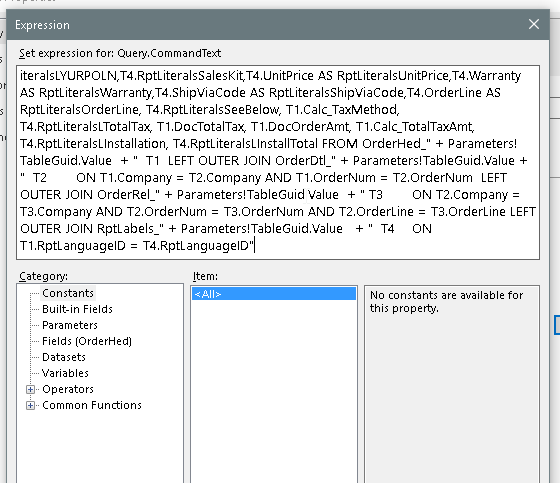

In the Query Editor window (with the cursor in the editor box), hit CTRL+END.
When I do this in the original SOForm RDL, I see:
Make sure yours ends with T4.RptLanguageID"

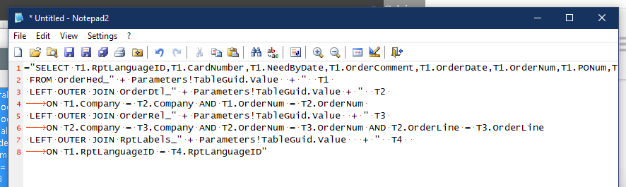

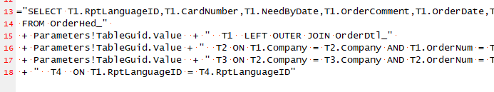

Hmmm… I did the copy and paste (of the original Query expression) into Notepad, and see that it already has line breaks in it.
That should be one single line. Or the breaks should be after the string literal is closed, like:

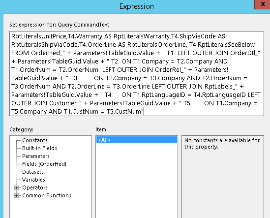

This is a custom report that I believe a consultant had done so it is a little different so it does not end in T4.RptLanguageID.

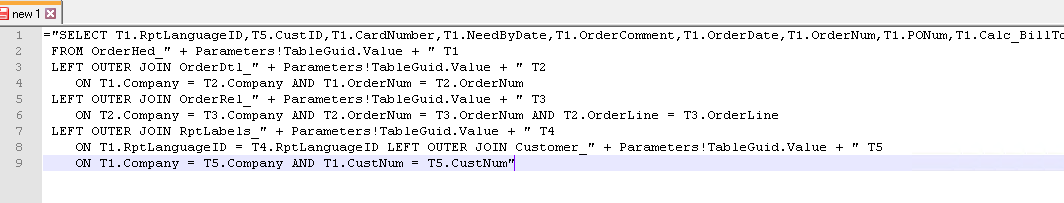

This is what the query appears as in Notepad++. Like yours it appears there are already line breaks:
Since the last LEFT OUTER JOIN is not on its own line, I added a line break to make it similar to the others. I then copied and pasted it into the Query expression and I am still getting errors. It is odd to me that this rdl works in live and not in test. Surely something else has to be the issue. What could that be?
