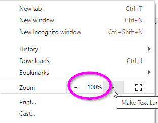

@jgiese.wci I looked into the apparent problem with the widgets. This turns out to be something that we fully know about AND is intentional.
The widgets are disabled when there is not enough room to actually work with them. When you make the screen too narrow, they become disabled. Simple as that. I did some experimenting with this with someone from the dev team and we found that:
  1. if you have your browser set to 100% zoom (ie… no zooming)
  2. you can take teh screen down to as low as about 1370 pixels wide. At that point the widgets are disabled
  3. Epicor recommends that for optimal use, you need to be on a screen that is at least 1440 pixels wide. Anything less than that will give sub-optimal performance
  4. BUT NOTE, if you ZOOM your browser, it changes what you can do. if you zoom to 200%, then your resolution is effectively cut in half, so even if you have a 1440 wide screen, when you zoom to 200 the screen becomes 720 wide, and it will be disabled again. (same in reverse… try setting zoom to 50% and it will work.
    All this to say, we know about this “problem” but it is not something that we can necessarily control. If the user runs Kinetic in a browser at a sub-optimal resolution and/or zooms, there may be situations where the software does things like this.
    (for those that dont know… below is google chrome zoom option… Microsoft Edge & Firefox have the same feature):

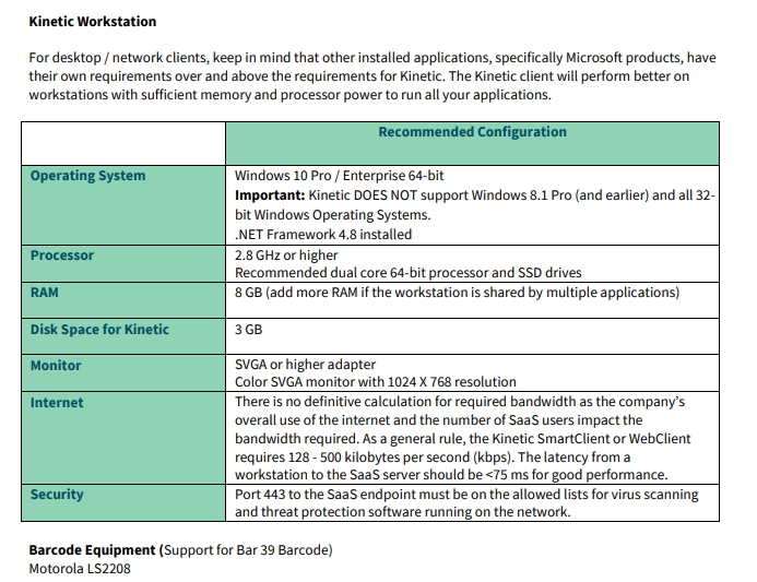

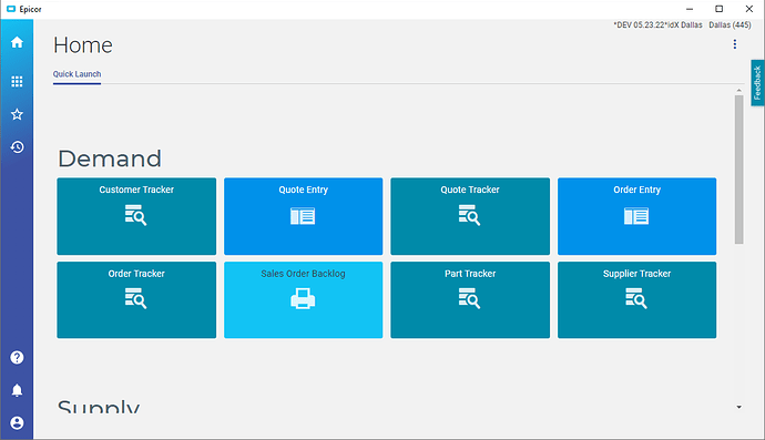

The Kinetic Client Requirements still state:
Second, the Kinetic Client (not Chrome) opens up in 1167x (still not 1300+)
So its a bug, until we remove the Client and go browser fully, or make the Client auto-start in full screen mode. Also update the requirements in the Hardware Sizing Guide.
As far as I know we are still buying 1024x to 1280x Raspberry Pie n-computes… because CAMs still reference the Hardware Sizing Guide as the ideal or minimum resolution for Kinetic.

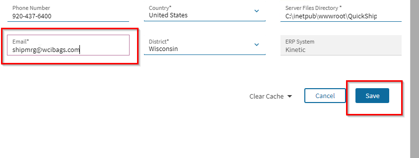

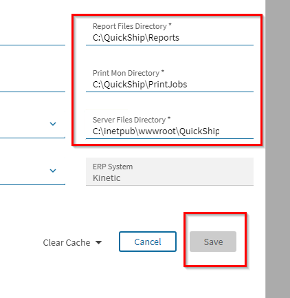

@timshuwy as Andrew described, that is the issue. I understand the purpose of the disable, totally get it, makes sense. It’s the user experience that is lacking. And I can’t justify putting in votes for something like that too many bigger fish to fry but all those idiosyncrasies are what are off-putting about Kinetic UI right now. I expressed that in the case CS0003367127 to the support rep, shortly before being asked to put in an idea to… make Kinetic better?
Do I put in a blanket idea “Make Kinetic UI user experience even moderately enjoyable”? Seems rude. Falls in line with this other case (CS0003317469) I entered for QuickShip for the same kinda crap. Save button is disabled because a field is missing data. Cool tell me which field when I click Save vs me spending 15 minutes trying to understand why the Save button is disabled. That or at least make it big and red required not a dinky little asterisk in the corner of a field in a see of options.
In this case I even provided the support rep what are considered widely accepted UX best practices
  • Until filled it should be highlighted.
  • Upon submission feedback should be generated.
  • All validation should happen in the business objects server-side vs field validation being performed client-side. Client side validation can be manipulated.
Still asked to put in an idea.

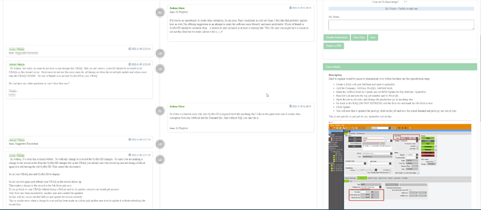

Another case where usability of the system comes into question but Epicor just puts it back on the user to know things CS0003368496.
Aaaaaaaaaaaaaaaaaaaand there it is. I know it’s not a black hole. I know from Controlled Release Ideas are looked at. But as the default response that’s why the general populace feels like it’s a black hole. Expectation “Enter all the ideas!” reality “but only 50, maybe”

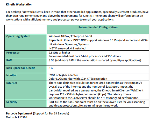

All I know is that our CAM said that all of Kinetic will work fine in 1024x and if you are on 1280 you are literally driving a Bugatti, :slight_smile: case closed, now the developers need to deliver on that. That doesn’t mean changing the requirements that were marketed and people purchased devices for. It is also documented in the requirements docs.
Being sarcastic… But I think thats another point that Development and Sales and Support need to talk more closer, become one…
