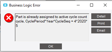

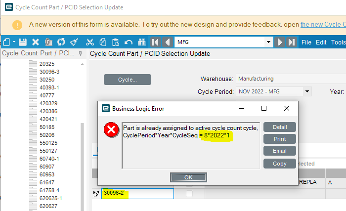

I am unable to enter a Cycle Count for a specific part and the error made me think it was in an open group, but it isn’t, I have already checked.
The Error says “Part is already assigned to active cycle count cycle. Cycle PeriodYearCycleSeq=420205”

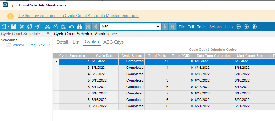

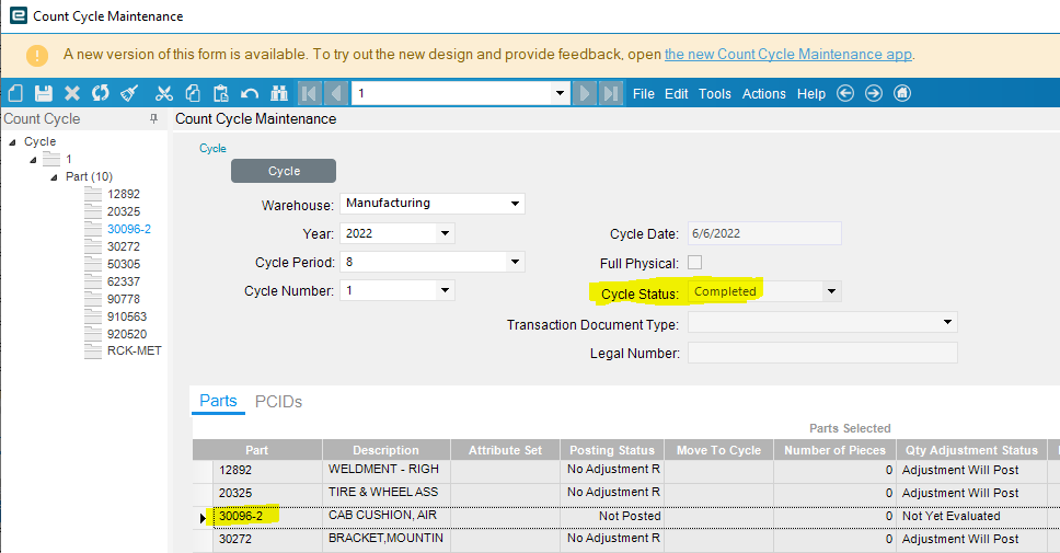

But… the cycle is long since completed…
And the whole “schedule” is actually complete.

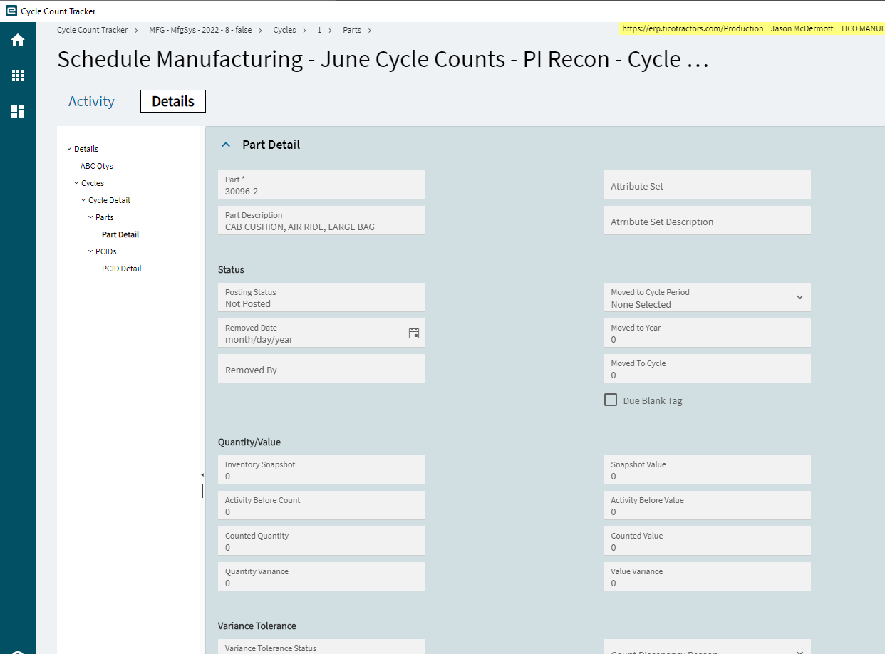

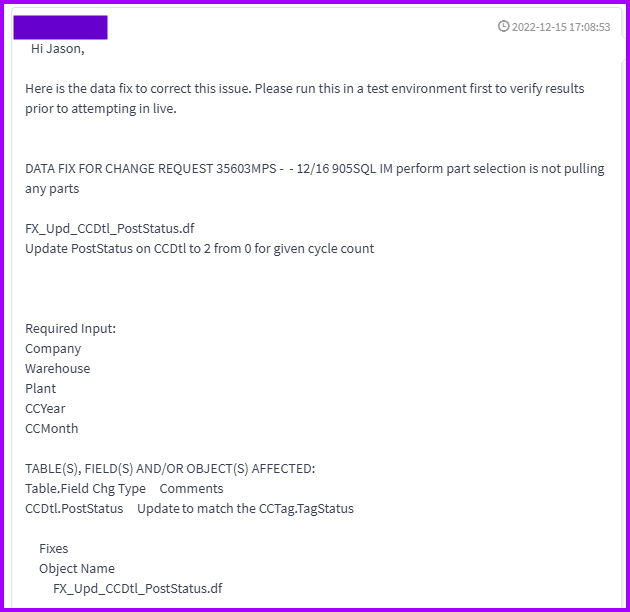

I see that the part was flagged with a status of 0 (“not posted”) but it looks more like the part was voided since all the quantities and dollar values are zero.
Time to make a ticket, I guess.

Did you ever get a resolution on this?
We are seeing the same thing
Thankyou very much!
