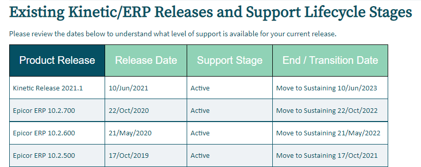

No, I think you have till 2022, right?
From EpicWeb:
https://epicweb.epicor.com/resources/Pages/Existing-Epicor-ERP-Releases-and-Lifecycle-Support-Stages.aspx
