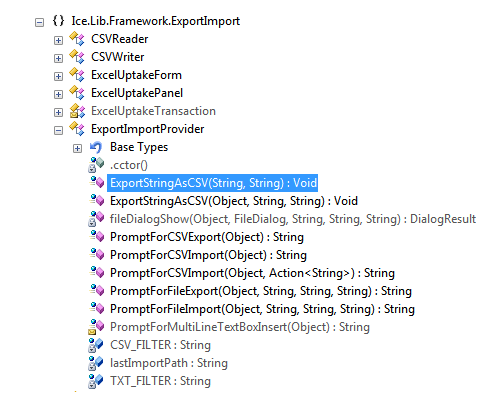

You might want to .NET Reflect or dotPeek on:
Now these won’t write the CSV for you, but they will help with making sure your CSV is up to the standards. Such as escaping characters, encapsulating spacings or chars with a comma into “” etc…
