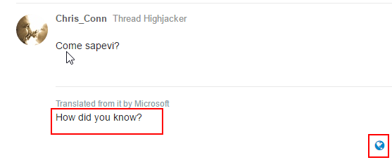

Damn italian coder!
Come sapevi?
cause of the spaguetti code :wink:
Also, way to go post translate!
Refactoring tool for our Italian coder?

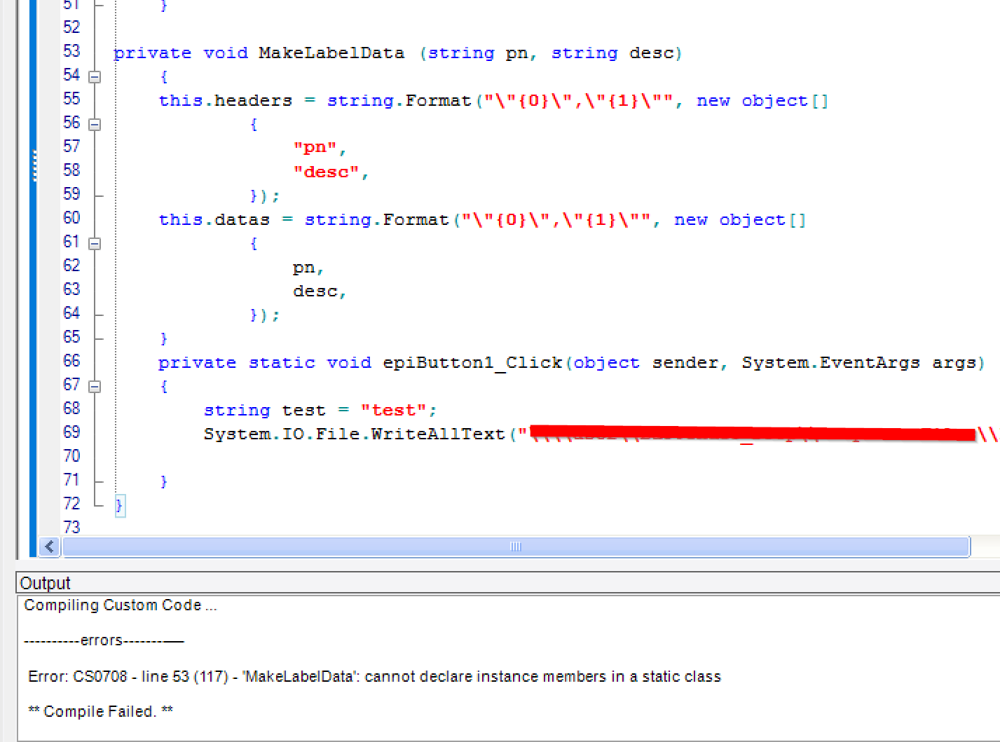

OK, so I am working on trying to get this to work. (remember I know veeerrryy little about coding and C# in general). For the first step I just wanted to get a file to pop out. I didn’t care what was in it, just get something to go where I wanted with something in it. I figured that out (although it’s embarrassing how long it took) . So here is the code for that.
	string test = "test";
	System.IO.File.WriteAllText("network location and file name",test);
That go plugged into the event wizard and it created this
private static void epiButton1_Click(object sender, System.EventArgs args)
	System.IO.File.WriteAllText("\network location and file name",test);
So I was able to figure out the first part of simple making a button do something.
Now I get stuck because I don’t know how exactly to get the data defined. I took your start with the MakeLabelData and shortened it to only part number and description (for example if I just want to make a part label) But I’m not sure where to put that. I’m assuming that you put a private void (that’s like a mini program right?) in front of the event call so that you can use the program within the button click?
It’s looking to me like something even this simple might be past my ability level, I don’t know the bare bones basics that I need to know about C#…

I’m glad you sent me the file so I could see your confusion. I guess I’ve never written custom code on top of a dashboard. I am not even sure how we reference the grid object in this case lol. We’ll figure it out - I need to learn how as well.
In the meantime:
I’ll give you a couple general pointers
private void MakeLabelData(string pn, string desc)
private means that this function cant be seen outside of this file.
void is the return type (we aren’t returning anything here)
pn and desc are parameters being passed into the function, both are of type string (text)
The { and } denote the start and end of the function. Notice there are other ‘groupings’ of text that use { } as well but they always come in pairs.
In your error above, I believe your problem is your dashboard is defined as static. I’ll avoid trying to go into what all of that means but suffice it to say you can compile by changing the function definition to:
private static void MakeLabelData (string pn, string desc)
Also we have to make our global vars static.
Ok I’ve figured it out. You have to deploy your dashboard as an assembly, Add it to you menu, then you can customize it proper.

            myCSV += "\"" + datastring + "\"";
Alright, I’ll have to try it later. I’ll have to get customization privaledges turned on. Generally our strategy so far has been to stay away from customizations if we can so we make sure any upgrade will be easier. This doesn’t really apply since it’s to a custom dashboard, but that’s one of the reasons that I haven’t had that turned on for me (along with the fact that I don’t know what I’m doing, but that’s beside the point. :wink:.)
Do I want that whole line in there? Or should I shorten that to just pn and desc?
I’m sure I’ll have more questions, but that was the first thing that I saw that seemed a little odd.
And to reiterate, the things that I should be changing to my system would be the 2 guids, (one for the button and one for the grid), and the network location for the drop. Right?
Sure enough, I missed that. Remove all but your string pn and string desc parameters. (I updated the code)
You are correct, that should get it going <fingers crossed >
I would point out that your BAQ has the PN limited - that may be on purpose but for my testing I had to remove it since I didn’t have any matching pn’s
