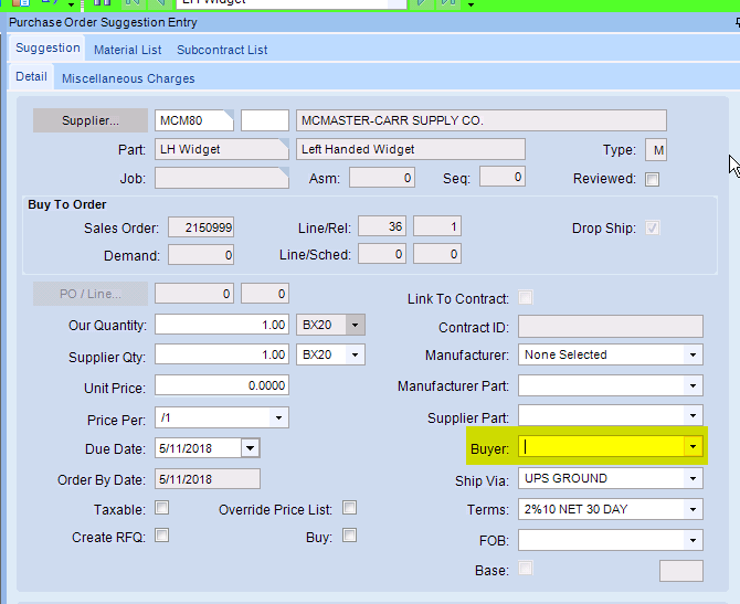

Buyer field in New PO Suggestions
Just starting to experiment with PO Suggestions, and I notice the Buyer field in PO Suggestion Entry always comes up blank. Any way to have it default to the buyer who is launched New PO Suggestions?
We have a Buyer setup for each user, added that user as an authorized buyer, and set that user as the default. Any place else I need to look?

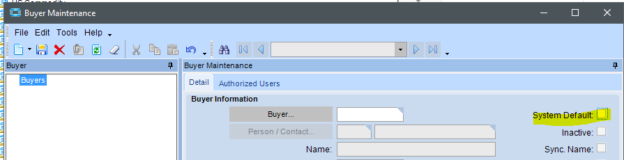

You can setup a default buyer that all these suggestions will get assigned to.

There is a hierarchy for defining which buyer is used…
In this example to help explain, i have two “Buyer codes” and THREE Authorized users:
Buyer Codes
  • Buyer1 (System Default)
    ** authorized users: Ted, Jane(Default)
  • Buyer2
    ** authorized users: Ted (default), Jane & Alice(Default)
The above setup means that Ted and Jane can both act as either buyer… alice can only buy under Buyer 2. Both Ted and Alice have their default buyer as Buyer2.
Also note that Alice cannot see any suggestions or POs that are assigned to Buyer1.
  1. if you are creating a PO Manually, Jane’s buyer code is Buyer1, Ted & Alice are buyer 2
  2. if MRP/Purchasing Suggestions create the suggestion, it will assign the buyer based on the following rules:
  • PartPlant have a Buyer? Use it - ELSE
  • PartClass have a Buyer? Use it - ELSE
  • Default back to the SYSTEM DEFAULT (Buyer1 above)
  1. if it is a sub-contract operation, then it uses the System Default (Buyer1)
(I think i got all that correct)…
The setup we used was to have a default buyer for all items. When we convert suggestions into PO’s, the buyer is manually changed by the person executing the PO. All of our buyers (or anyone who has to see suggestions) are listed as authorized buyers under the default buyer.
Works pretty well, even though it’s not quite how some other systems work. Gives us a way to see all suggestions at once.

Basically, for BTO parts that are NOT in the Part master the PO Suggestion Buyer will either be blank or it will be set to the Buyer marked as the default buyer.
If having one default buyer for all BTO parts wouldn’t work, then what logic does your company use to determine who should purchase each part?
