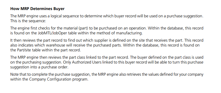

Here is a snip from the technical reference:
And here are selection steps from an (old) answerbook, I think they still apply:
  1. If subcontract check if a Buyer is specified on the Operation Master
  2. Then check if a Buyer is specified on the part master → Site sheet (Plant) .
  3. Then check if a Buyer is specified on on the Part Class
  4. Then check for the “System” Buyer in Buyer Maintenance.
  5. If a BuyerID is blank on PO Suggestion , all users should be able to see that suggestion.
