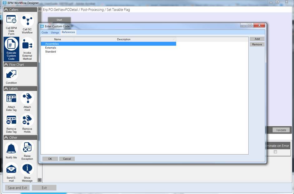

That is correct. Whenever you use a new using statement, there is usually an associated library you must reference.
Check out the Customization Guide (Sign In) and go page 721 for an example on how to do this.

I’m in a BPM, though, not a customization.

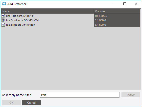

So, I got the XFileRef assembly, but Ice.Contracts.Bo.XFileAttch doesn’t seem to exist.
How do I reference the XFileAttch assembly so I can update the table?
Try Ice.Contracts.BO.Attachment
(Did you put the Triggers references in there or was that automatic?)
Alright, so apparently it’s Erp.Contracts.Drawings.

I didn’t add those triggers. I just did a filter of the assemblies for anything that started with XFile.

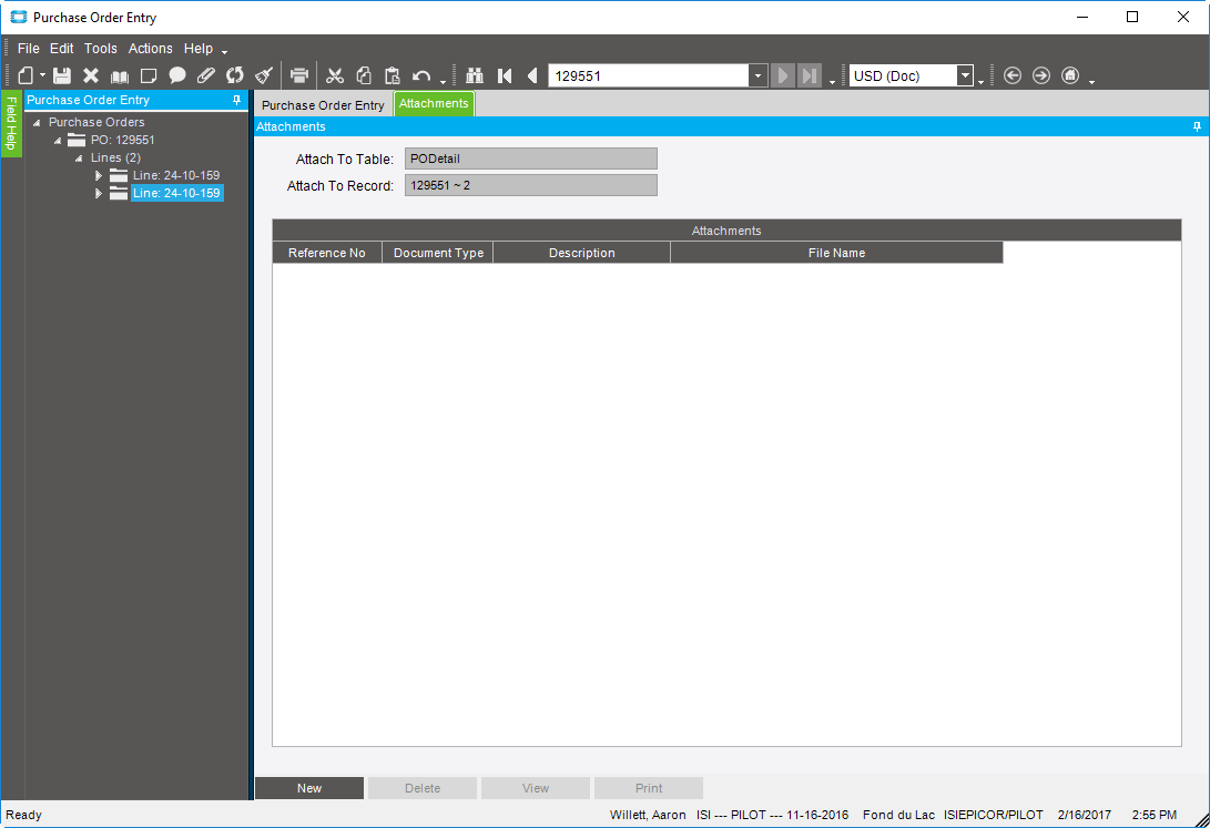

Okay, so I got it so it adds the records to the table. I figured it would be automatic that it would show up under that attachments, or at least a refresh required. Is there anything special that needs to happen there?
If you add one manually, how do the records compare to the ones you added through the BPM?
You might have to add a customization that refreshes the screen after the BPM fires. Others may know how to refresh from a BPM. Usually, if custom code is only going to run in a single command, I use a customization but if it has to run no matter what the source of control, then I use a BPM.
The lines in the table appear the same. The only thing I can’t get to populate is the file description.
