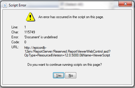

Hello guys i am having an error when i run the ssrs report inside the system with my customization i have narrow down the problem and i know the problem is the report server the viewer file but i have no idea how to fix it bellow i will add my code and the error screen.

Hi Alex
That is likely because the version of the IE Explorer engine that the WebBrowser control uses is old. Version 7 I believe… you are going to have to use a different control and set the configuration of your WebBrowser control to use a more recent version of the IE Engine.
i have the last version IE 11 and also when i open the report outside of epicor directly with IE i dont have that error i just get the eror when i open it inside epicor. and my default browser is IE
Your best bet here is to use the ReportViewer control which is built specifically to render SSRS Reports as I pointed out before. The web browser control is clumsy at best and will require a lot of tweaking to make it work

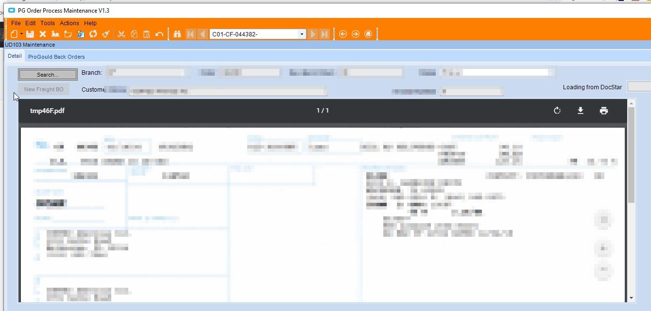

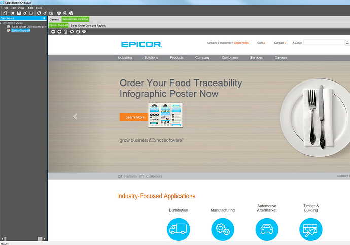

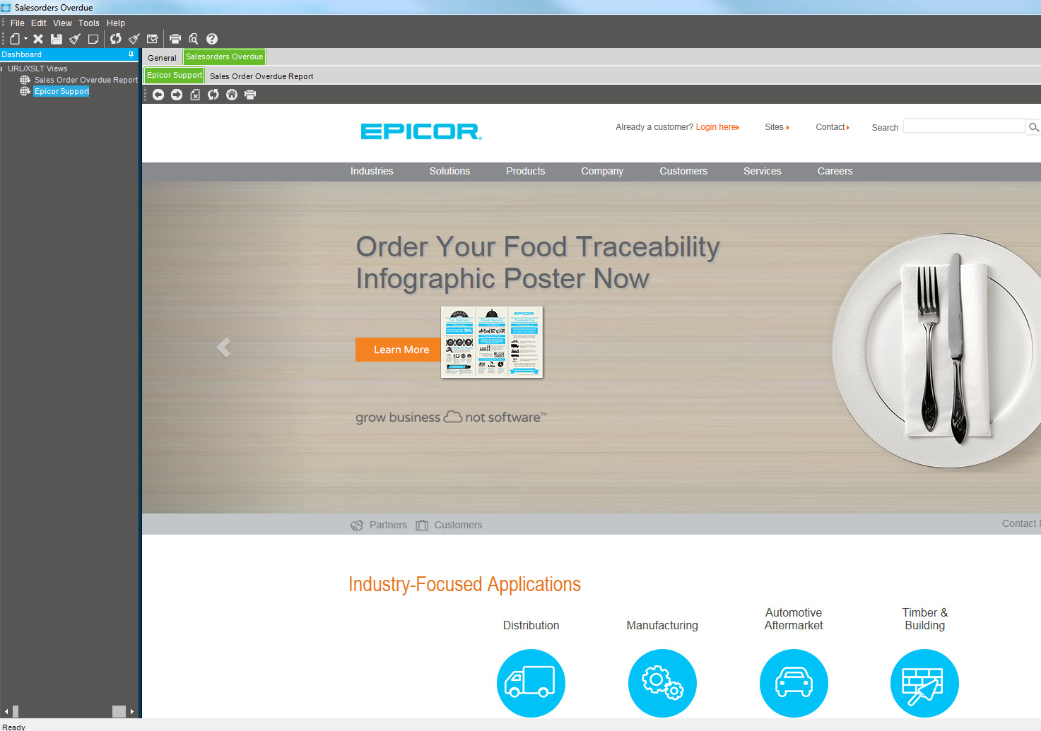

Yes that is a little used function.
You can reference the attachments linked to things in a dashboard like PDFs and have them display using that function.
We showed this the accounts team at one customer and they liked reviewing the scanned in Logged AP invoices.

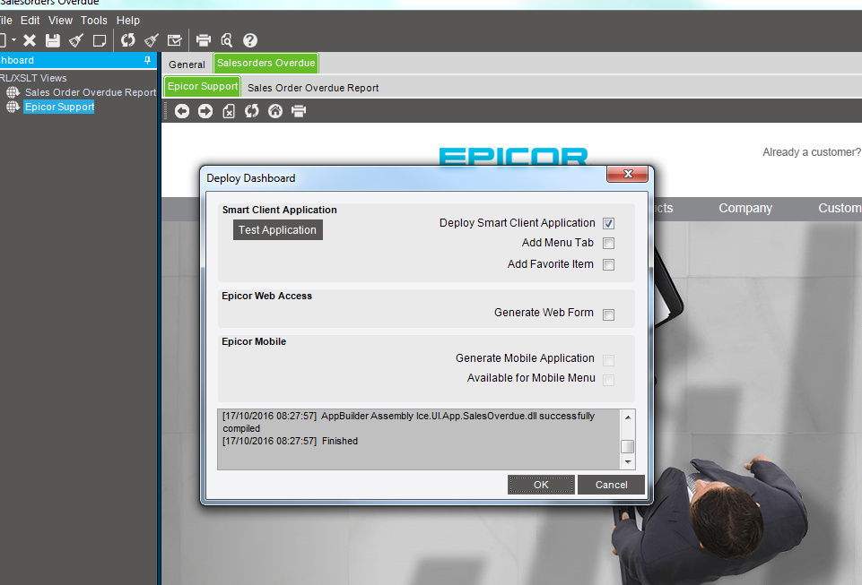

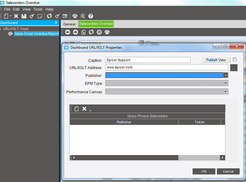

We are in Epicor 10.1.400.8. All works fine in our system. can you test it by entering url as www.google.com or www.epicor.com. whats your Epicor version?
FYI: you can dynamically change the url applying tokens in the “Query Phrase Subscribers”. the right click context menu does not work. still ctrl+c works.
