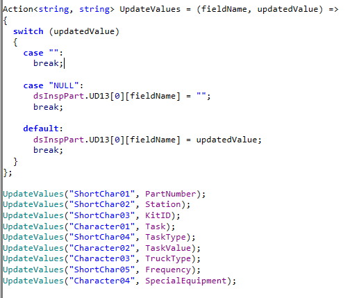

So, I’m still no coder, but I will admit, setting variables in widgets is absurd when you have 24 to do like I am dealing with. So I’m doing this in C#. Yes, let’s hear it. I’m ready. :boxing_glove: :boxing_glove:
I started with the green commented-out section at the end (dataset field = input). That worked fine.
Then a lightbulb - if my user passes a blank (empty string) for a value, do I interpret that as
  • The user wants to overwrite the data to now be blank?
  • Or they just want to skip over it and leave it as the original value?
And the answer was that he wanted blank to mean “leave it alone.” On the flip side, if he wants to actually clear a field (set it to an empty string), we agreed to send over the string "NULL".
So, the new code I made works fine, too. It’s just ugly. I did nested ternary operators () ? :
In short, it says:
field1 = (input1 == "") ? field1 : (input1 == "NULL") ? "" : input1
But it just seems excessive when I do it for 24 fields (this example has 9; another has 24).
If it were SQL, I’d write
case input1 when '' then field1 when 'NULL' then '' else input1 end
OK, I guess that’s literally the same length. But I guess my point is that it would scale better if I had more “whens.”
Anyway, if there’s some more intelligent strategy to this, please share.

What if you turned it into a function? something like this:
private static void UpdateValues(string fieldName, string updatedValue)
  switch (updatedValue)
    case "":
      break;
    case "NULL":
      dsInspPart.UD13[0][fieldName] = "";
      break;
    default:
      dsInspPart.UD13[0][fieldName] = updatedValue;
      break;
Then just looped through each value in a foreach statement and pass the fieldName and value into the function?

So then my setter statements would just be
UpdateValues(field1, input1);
UpdateValues(field2, input2);
//etc...
I like this.

Hmm, so is that not allowed in a code block widget?
Nope, you can’t make methods in BPM. But you can make actions (no return) or functions (returns something). You have to put them at the top of your code because they must be created before you call them, but once they are made, you can call them like any other method.

Action<string, string> WT = (myVar, myVar2) =>
        //do stuff here, myVar, myVar2  are your parameters passed in
Add as many inputs as you need, then the last one is your output.
Func<string, string> GetFunction = (inString) =>
   //do stuff here using inString
  return myResult;
I’m not sure if my syntax is exactly right, but should be close enough for you to get the gist.
@Banderson
It sure is. This works:
I found Func by searching for the error on here, but I would never have known about Action.
Func would work, but I was returning a value for no good reason.
Sweet!
I like this; this is traditional VBA-style stuff. I’ve done plenty of Excel macros, so this is familiar.
Now, the adapters and all that… yikes. Give me widgets.
