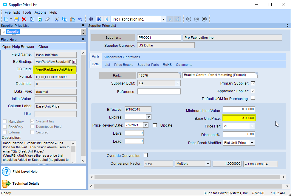

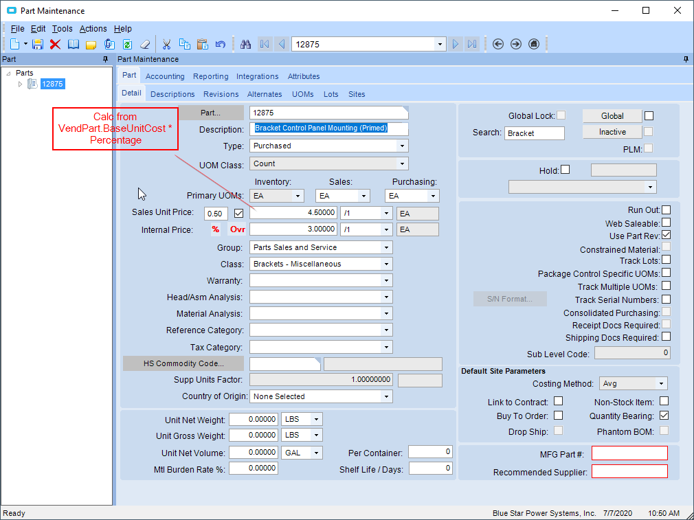

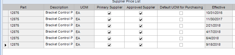

I’m experimenting and changing my plans as I go. So far my goal is to try and have Sales Pricing automatically updated with our Supplier Price List. (condition: default supplier, latest effective date, etc.)
I have create a UD field in Part table to store a percentage field which will assist in multiplying the VendPart.BaseUnitPrice * Part.SalePricePercentage_c
I’m having a problem using Method Directive to update this value. When i build the method directive on VendPart.Update it will map reverse of what I want it to. Basically would like to copy the data since i cannot retreive it from Part Form.

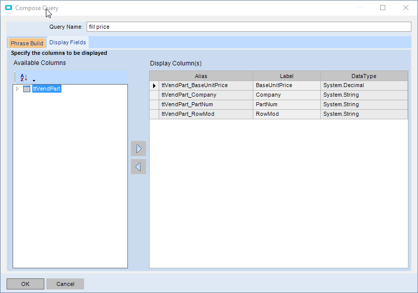

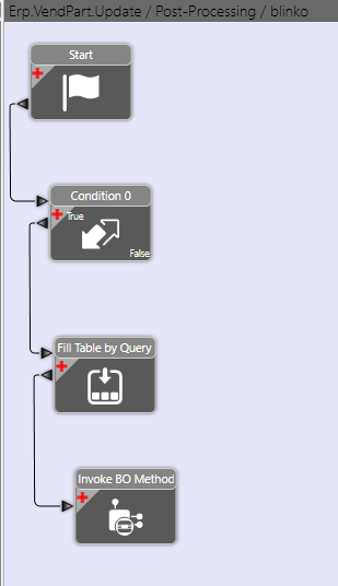

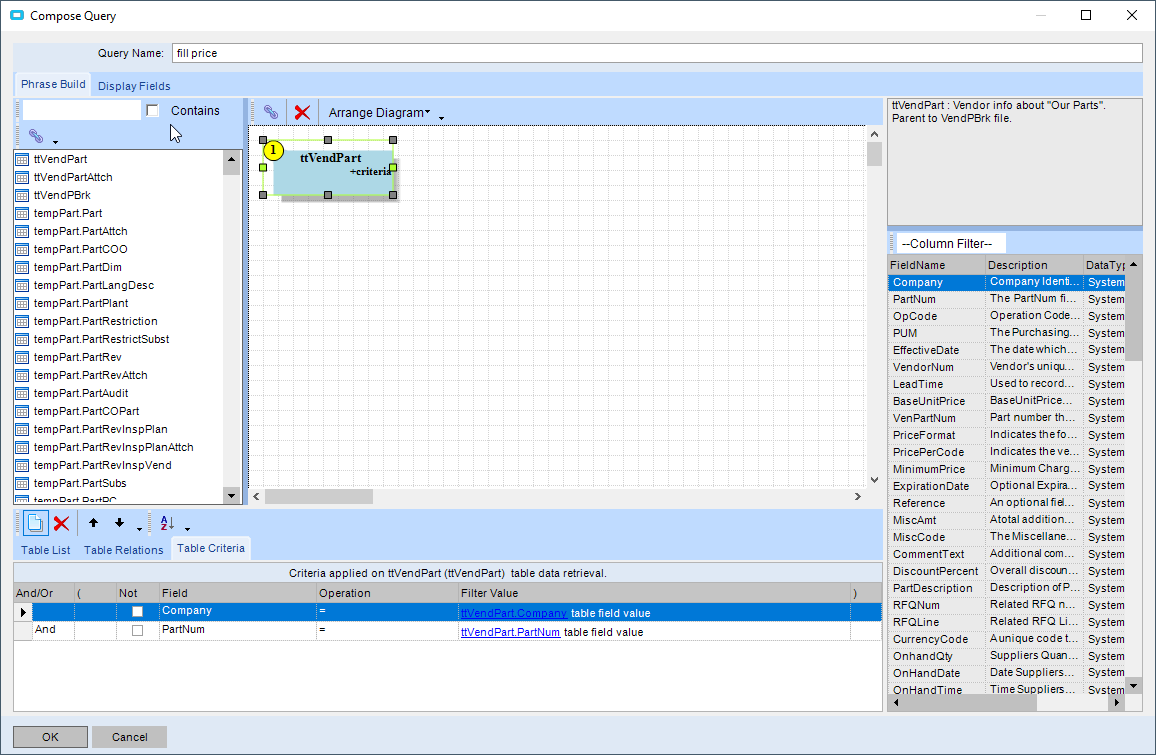

I probably did not explain this well but here are some screenshots.

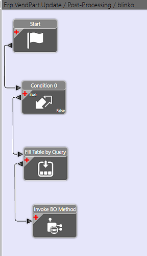

On Vendor List Update (post processing)
Lookup the related Part Record then Update the Part.UnitPrice field accordingly.
Yes.

Here is the scope of what was requested.
1 Populate Part.InternalUnitPrice (Internal Price) with correct value from Supplier Price List
2 Calculate percentage (from new UD field) markup onto Part.UnitPrice (Sales Unit Price)
3 Use override Checkbox (UD Field) to manually enter Sales Unit Price and ignore BPM.

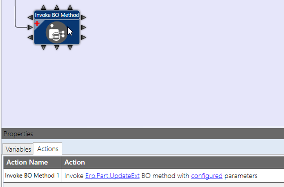

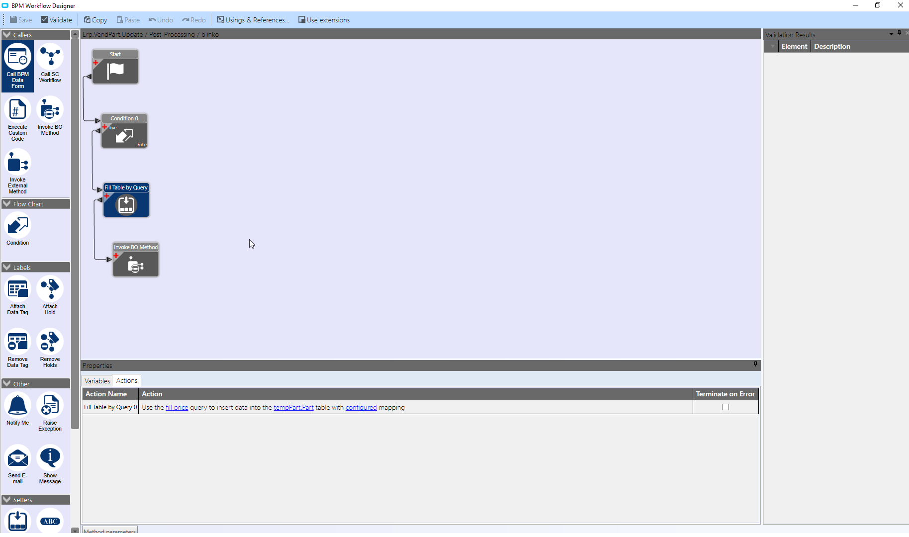

I need another push. I cannot get this to write the value to part.InternalUnitPrice

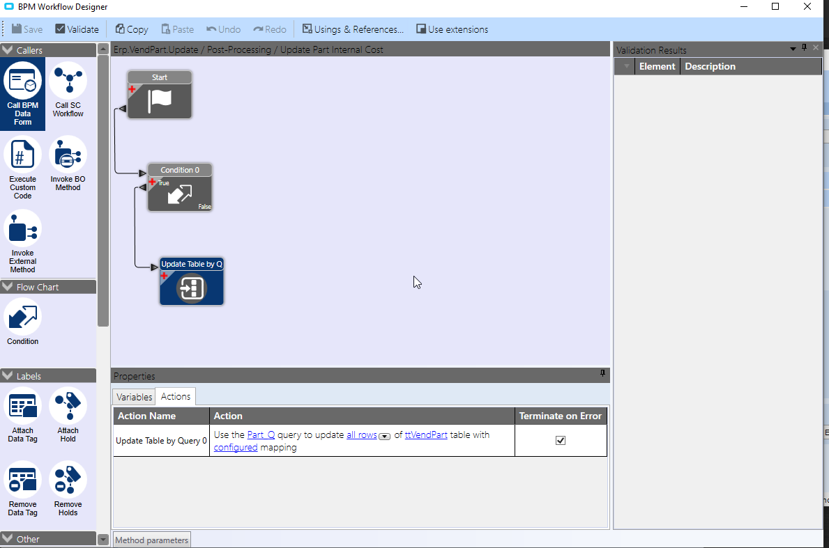

Is this the correct method directive?
Is your BPM Firing? (How do you know)
Yeah. BPM name is “Cheese” =)
I can see the value change in the trace log for VendPart.BaseUnitPrice. I don’t see anything about Part.InternalUnitCost
<changedValue tableName="VendPart" rowState="Modified" rowNum="0" colName="BaseUnitPrice"><![CDATA[69.00000]]></changedValue>
<changedValue tableName="VendPart" rowState="Modified" rowNum="0" colName="UD_SysRevID"><![CDATA[System.Byte[]]]></changedValue>
<BpmDirective Type="3" ID="ef87c9ce-607e-467b-b8fd-df0bd3e24602" Name="cheese" VisibilityScope="0" PreparationStepDuration="0" Duration="69" />[full.txt|attachment](upload://c6r2rPzYlminzPzIQhYuz86hQID.txt) (3.1 KB)

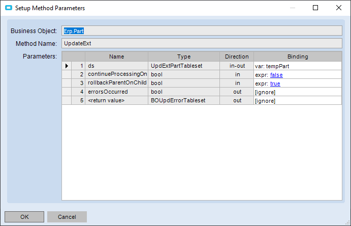

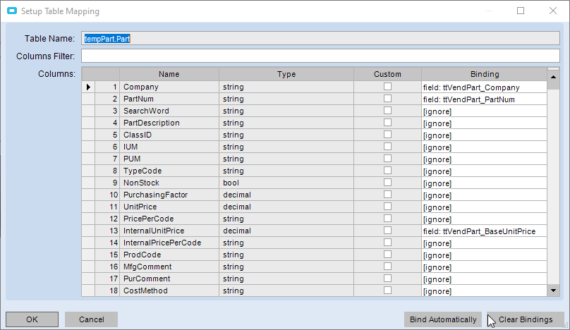

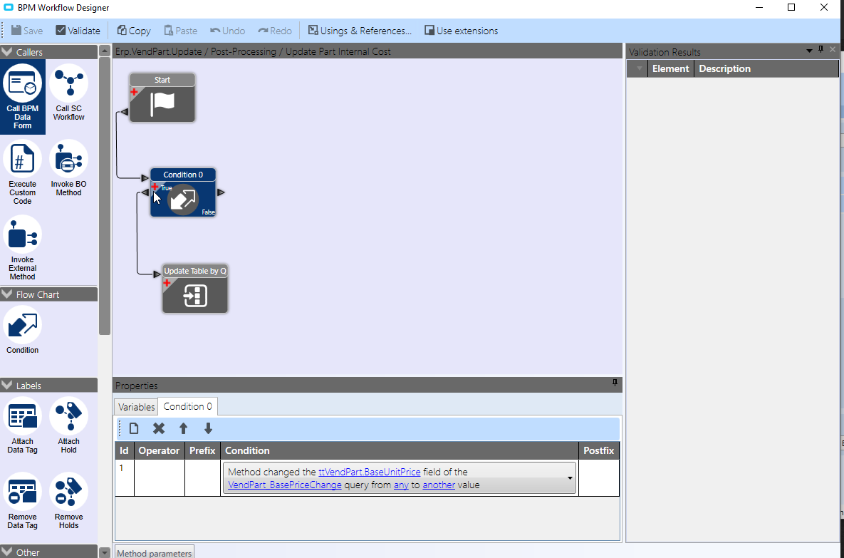

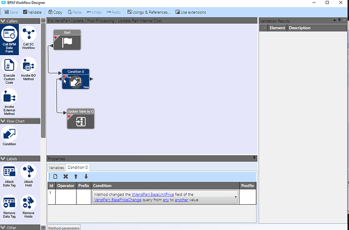

Found this knowledge base article and got it working but not quite the way I want to. It will update when the part form is saved (output area) but not when the supplier price list is changed (input area). I’ll try to work with that for a while.

- Select the Update Table by Query widget and click on the Specified query link
- Give the Query an appropriate Name, e.g., CustomerComment
- Add the ttOrderHed table then select it. Add a Table Criteria of RowMod = “A”
- This will filter for only added (new) Orders.
- Add the Customer table and join it to the ttOrderHed table. Select the Join and add the following Table Relations: Company to Company, CustNum to CustNum
- Go to the Display Fields tab and add the following fields: ttOrderHed.Company, ttOrderHed.OrderNum, ttOrderHed.RowMod, Customer.Comment
- Click OK to save the BPM Query
