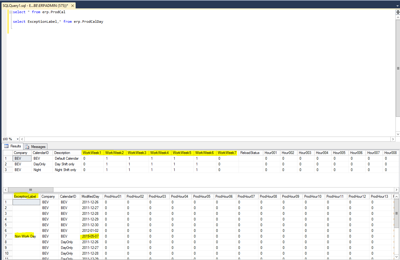

For each Production Calendar in use (we use three), one CheckBox field is set to true if the day is a working day in that calendar.

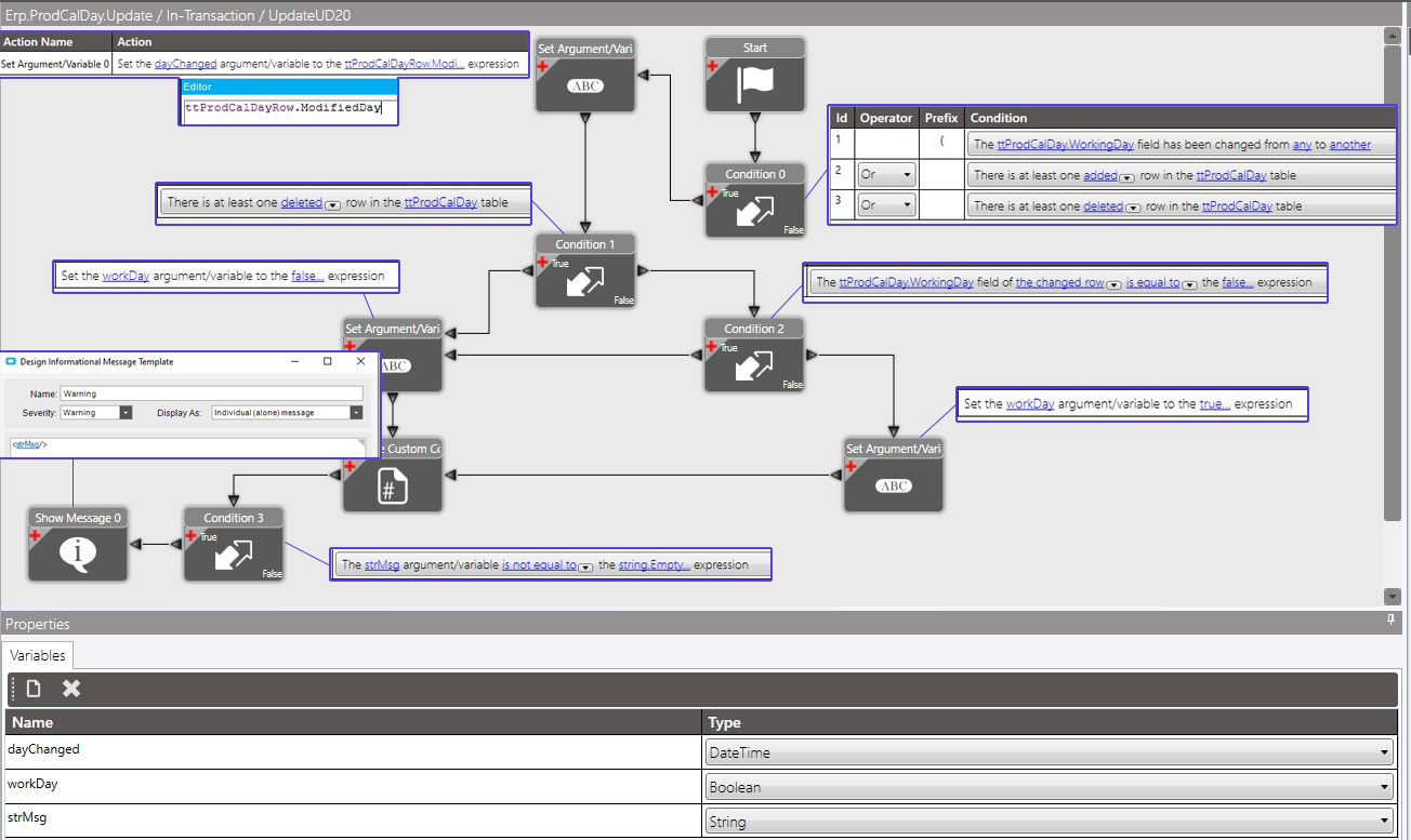

A BPM on ProdCalDay.Update (data directive) then maintains the relevant CheckBox and Number fields if anyone makes changes to the working days in any of the Production Calendars.

The BPM looks like this:
with custom code
string cal = (string)(from row in ttProdCalDay where row.RowMod == "A" || row.RowMod == "U" select row.CalendarID).FirstOrDefault() ?? string.Empty;
string calnum = string.Empty;
switch (cal)
case "Calendar1":
calnum = "01";
break;
case "Calendar2":
calnum = "02";
break;
case "Calendar3":
calnum = "03";
break;
if (calnum != string.Empty)
var ud20 = (from row in Db.UD20 where row.Company == Session.CompanyID && row.Date01 >= dayChanged select row);
strMsg = string.Empty;
using (var txScope = IceContext.CreateDefaultTransactionScope())
foreach (var ud20row in ud20)
if (ud20row.Date01 == dayChanged)
if ((bool)ud20row["CheckBox" + calnum] == workDay)
break;
else
ud20row["CheckBox" + calnum] = workDay;
if (workDay)
ud20row["Number" + calnum] = (decimal)ud20row["Number" + calnum] + 1;
else
ud20row["Number" + calnum] = (decimal)ud20row["Number" + calnum] - 1;
try
Db.Validate();
if (txScope != null)
txScope.Complete();
catch (Exception e)
strMsg = "Error updating Master Calendar." + System.Environment.NewLine + e.Message;

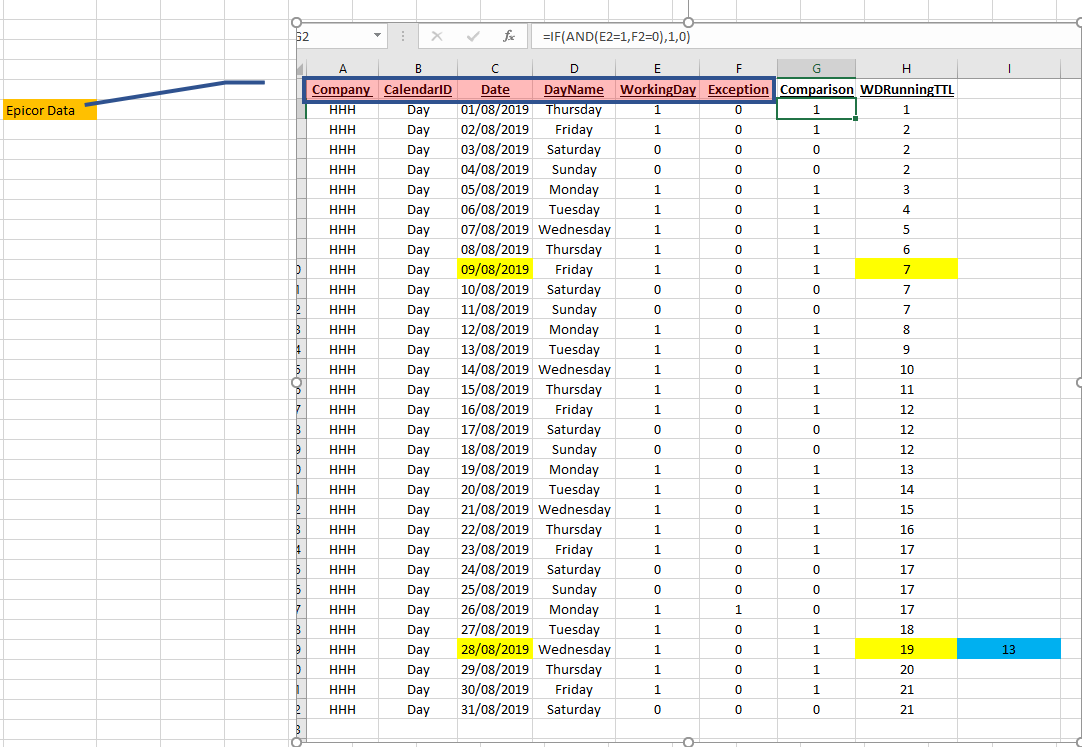

Many thanks Daryl, really appreciate that mate, but i am thinking of similar solution and could be easier, - i am thinking loudly here- all your feedbacks are welcome, i am trying to create a BPM to calculate running total of WorkingDays and Exceptions on a UD table, triggered every day, as well as updated/added events on ProdCal, the BPM basically have calendar info stored against date as well as running total (based on first day Epicor been used), then simply when any BPM/BAQ/SQL need to find the working days for any calendar all what you need to do is calling the running total for each date and subtracting them from each other with +1 to be inclusive if wanted.
That is exactly what we have, stored in UD20 in our case.
Your WDRunningTTL column is our UD20.Number01 for Calendar01, and your Date column is our UD20.Date01.
