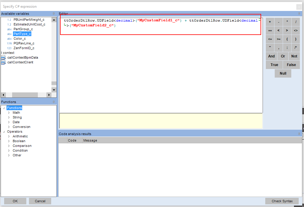

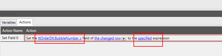

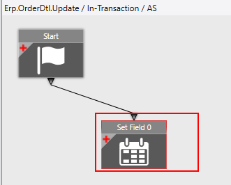

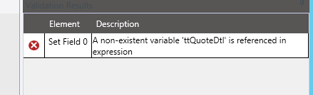

I tried an in-transaction data directive to set the field, but for some reason I can’t reference the UD fields in the expression. Would prefer a solution which doesn’t involve using custom code.
