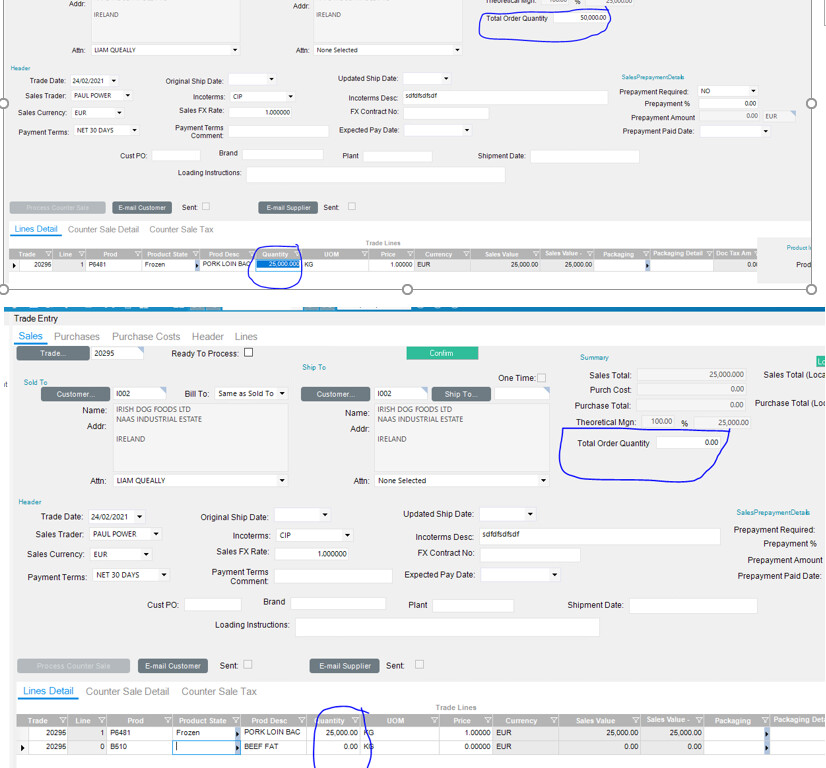

Hi Brandon @Banderson
I have been working on this again today and have been trying the AfterFieldChange event.
What happens now is;
  1. When i add a line, the Selling Quantity doubles itself in my UD Field. This is an issue with my code as I am using the + operator as opposed to a sum function. I cannot seem to get the sum function to work. I have tried Sum() and Enumerable.Sum().
  2. Secondly, when i add a second line, the UD field reverts to 0. When i add in a quantity on that second line, it does the same as the above again except on the second line only.
Would you have any further thoughts? I would really appreciate it.

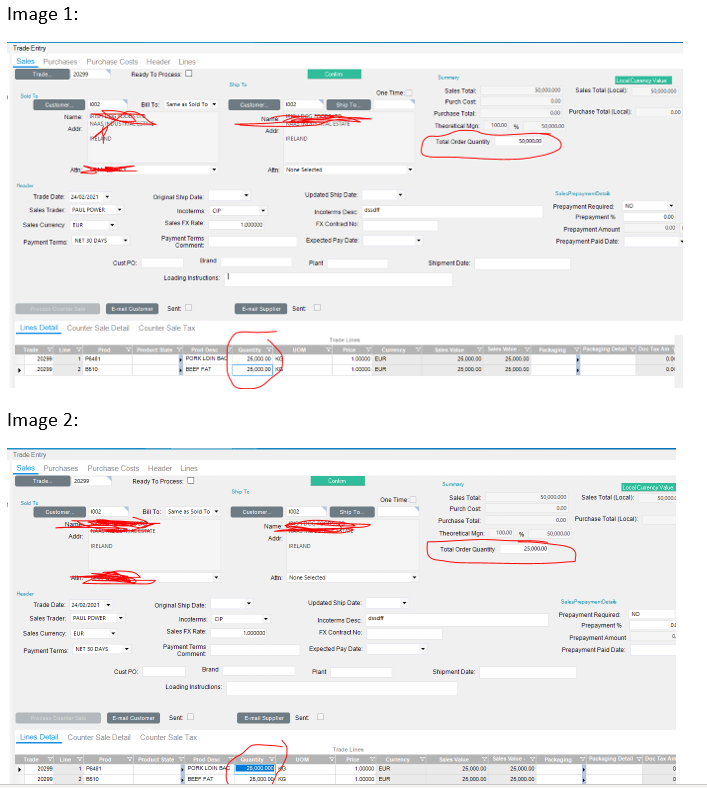

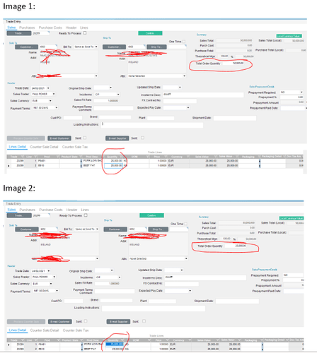

Thank you Brandon @Banderson .
I think I got it. As you can see from the image 1 below, I have added 2 lines to my order. Each line is for 25,000 kgs each. The UD field correctly displays 50,000 kgs as required.
The only thing this does is, if i click on the first line, the value resets to the quantity on the first line. Even when more than one line has been added (image 2). This does not recalculate even if the user navigates away from OrderDtl.
Would that be because i have placed the event on OrderDtl and in fact should have the event on OrderHed (I have also bound the field to OrderDtl as opposed to OrderHed)?
