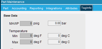

I have two UD fields that define temperature limits in deg F, and are entered in Part Entry in deg F. I also want the values to show in degC. I had created a TextChanged event that puts the calculated value in the appropriate text field, but since the degC field isn’t actually saved in the database it displays as zero the next time the form is loaded in part entry or in part tracker. I tried other form events to do the same, but none seemed to do anything. Can anyone point me to the correct even to use for something like this? It doesn’t seem like it should be necessary to store the converted value in another field in the database.

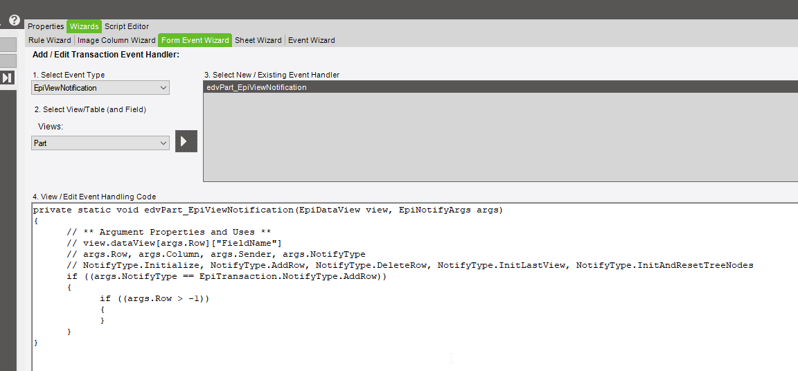

I must be doing something wrong here. I added an EpiViewNotification through the form event wizard to a PartTracker customization, but it doesn’t appear to be firing. I added Message Boxes to test but nothing happens after loading a part or multiple parts into the form.
this.edvPart = ((EpiDataView)(this.oTrans.EpiDataViews["Part"]));
this.edvPart.EpiViewNotification += new EpiViewNotification(this.edvPart_EpiViewNotification);
private void edvPart_EpiViewNotification(EpiDataView view, EpiNotifyArgs args)
// view.dataView[args.Row]["FieldName"]
// args.Row, args.Column, args.Sender, args.NotifyType
// NotifyType.Initialize, NotifyType.AddRow, NotifyType.DeleteRow, NotifyType.InitLastView, NotifyType.InitAndResetTreeNodes
if ((args.NotifyType == EpiTransaction.NotifyType.AddRow))
{ MessageBox.Show("View addrow");
if ((args.Row > -1))
{ MessageBox.Show("View args > -1");

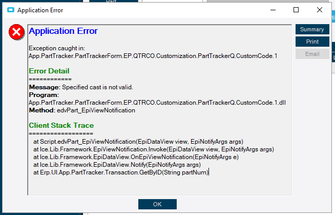

That worked to get it firing. Now it shows both Message Boxes and then throws an error. This is without any custom code inside of the if ((args.Row > -1)){} statement
Message: Specified cast is not valid.
Program: App.PartTracker.PartTrackerForm.EP.QTRCO.Customization.PartTrackerQ.CustomCode.1.dll
Method: edvPart_EpiViewNotification
Client Stack Trace
at Script.edvPart_EpiViewNotification(EpiDataView view, EpiNotifyArgs args)
at Ice.Lib.Framework.EpiViewNotification.Invoke(EpiDataView view, EpiNotifyArgs args)
at Ice.Lib.Framework.EpiDataView.OnEpiViewNotification(EpiNotifyArgs e)
at Ice.Lib.Framework.EpiDataView.Notify(EpiNotifyArgs args)
at Erp.UI.App.PartTracker.Transaction.GetByID(String partNum)

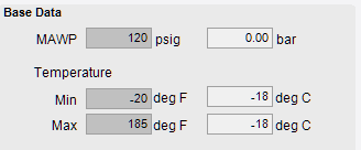

Almost there. The conversion fires and fills the new fields, but the fields to be converted are always treated as zero (see below, -20F should convert to -29C, 0F is -18C). Is there a way to have the EpiViewNotification fire later after the data is read?
Calvin is correct. When I open part tracker I expect the fields to have zero value, but when I search for and select a part all of the data loads which populates those fields. My code is still treating the fields as though they have zero value, however. Below is the full code:

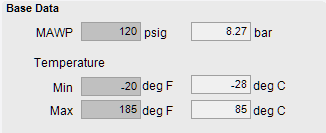

Correct, the message boxes also just showed 0 (or values converted from 0). I replaced my field.value statements with epiDataView statements and everything started working. Not sure why exactly, but referencing the current value of a form field doesn’t work as I think it should. I suppose calling the epiDataView is likely a better practice anyway.
My wild ass guess is, the data view is updating, then it’s triggering your event, then it’s updating the UI. So you were probably getting in the middle of it. Glad you figured it out!
