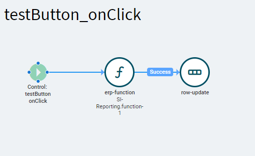

Looks like you found a solution but you could also do it without a BPM by calling an erp-function tool inside of an event (like a button onclicked event). In function maintenance, make a custom code function with 2 input parameters and 1 return value for your result. Inside the custom code editor, write your formula and then set the return value equal to the resultant of this formula.
To set a dataview equal to your return value from the function, make the OnSuccess event of the erp-function point to a row-update tool. In row-update, go to Parameters then Columns and then set the Ep Binding to your dataview and the value to “{actionResult.NAMEOFYOURRETURNVALUE}”.

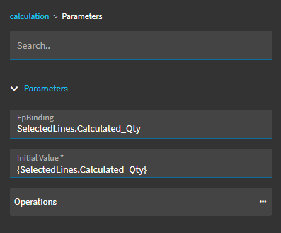

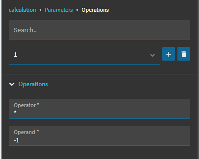

I know this was solved, but the fact that it uses a function seems like overkill to me. You can do this without a function, by using the calculation Widget and updating the other UD field.
This calculation widget takes a Number and multiples it by -1.
