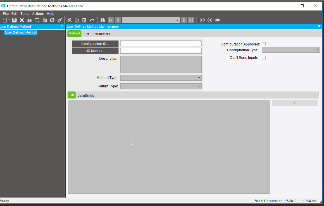

Yeah, so you can make a UDMethod. You need to go to User Defined Methods Entry. (That’s what it says in the book)
Here it is. You can make your method here, then call it when you want in the configurator.
Then when you use it in the configurator, it’s UDMethods.YourMethodName();
Thanks. Got it working.
