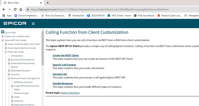

In the Epicor help there’s a whole section on calling functions in classic customizations. Take a look there

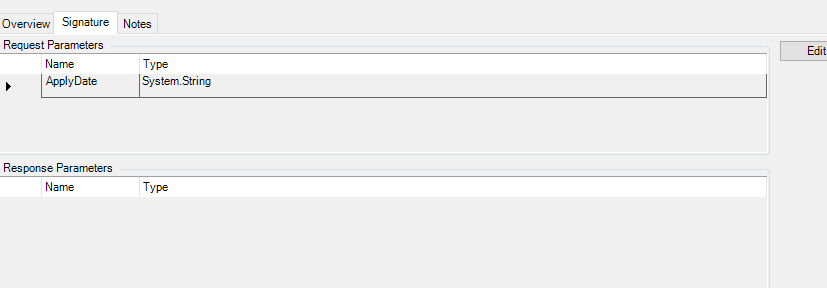

I set up a request and response parameter (although I am not using the response for anything)

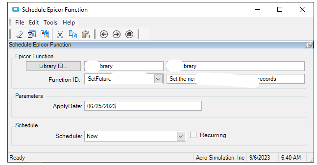

Post a screenshot of what you schedule when you schedule it

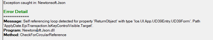

It does not like the “o” in the ToString(). I have tried other ways of not converting it at all and trying to pass a different string variable in but it doesn’t like it. One of the errors I get is

I have already changed it to be a string:
It doesn’t like passing a date type via the query execution parameter so I changed it to a string. This is what I have in my function, which works when I call it via the Schedule Epicor Function.

Here is the snapshot of the function schedule
I’m not sure why you feel the need to white out the Libaray and Method names but ok… I’m assuming then you changed the names in this post too?
