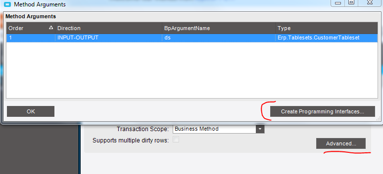

I don’t have 10.2.400 infront of me now, but what if you open up Method Directives or Data Directives and click on the Advanced Programming - or - generate a new template using Service Designer in 10.2.400 to see what the new boilerplate generated looks like.
