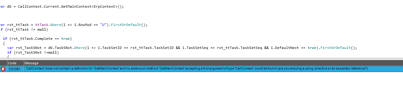

System.Drawing.Bitmap CS1061 ‘CallContext’ does not contain a definition for ‘GetMainContext’ and no extension method ‘GetMainContext’ accepting a first argument of type ‘CallContext’ could be found (are you missing a using directive or an assembly reference?)

Thanks for the quick response, can you please confirm that the changes I have done to the code is right…
This is the original bpm
var db = CallContext.Current.GetMainContext(); //Commented this
var rst_ttTask = ttTask.Where(i => i.RowMod == “U”).FirstOrDefault();
if (rst_ttTask != null)
if (rst_ttTask.Complete == true)
                            var rst_TaskSNxt = db.TaskSNxt.Where(i => i.TaskSetID == rst_ttTask.TaskSetID && i.TaskSetSeq == rst_ttTask.TaskSetSeq && i.DefaultNext == true).FirstOrDefault();
                            if (rst_TaskSNxt !=null)
                                            rst_ttTask.NextTaskSeq = rst_TaskSNxt.NextTaskSeq;
                            //this.PublishInfoMessage(messageText, Ice.Common.BusinessObjectMessageType.Information, Ice.Bpm.InfoMessageDisplayMode.Individual, boName, methodName);
            else
                            rst_ttTask.NextTaskSeq = 0;
This is what I changed as per your suggestion…and am not getting that error …just wanted to confirm whether this is correct
//var db = CallContext.Current.GetMainContext();
var rst_TaskSNxt = Db.TaskSNxt.Where(i => i.TaskSetID == rst_ttTask.TaskSetID && i.TaskSetSeq == rst_ttTask.TaskSetSeq && i.DefaultNext == true).FirstOrDefault();
else
